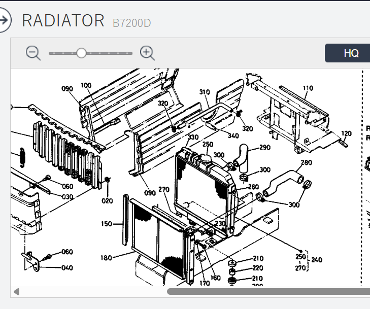

New Here Bought a B7200D awhile back its an oldie but runs like a top. put new drums and brakes on it. Have a parts manual for it but it dosnt show the hose between the radiator and the cross pipe and when i look up the number for the small hose between bottom of radiator and the block all i find is the bigger hose that looks like its between the water pump and the metal cross tube.
Any Help will by Appreciated

Lol yep took me awhile to find them in to different sections. been looking for 280 in the pic North Idaho Wolfman sent. I looked at the website he showed and its the same as my book. Still havnt seen the pic with the lower hose from radiator to the metal cross pipe yet ive ordered the one from metal pipe to pump. All the numbers ive looked up on the #280 show a short straight hose mines bent like the pic.
Thanks
Willie

Hey Thanks come to find out #280 is the hose from radiator to metal cross tube i thought it was the drain one there pic is is wrong. Found #310 is the i also needed.
Thank You
Willie
