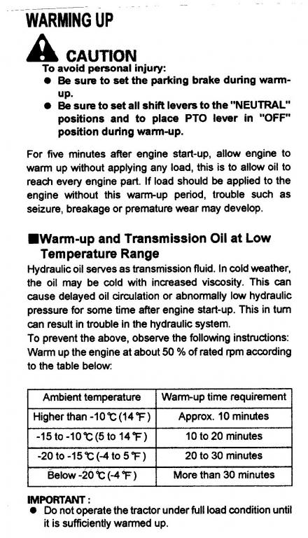

You need to be giving your tractors hydraulics time to warm up before using the machine. I have attached a chart for more modern machines but it will give you an idea for yours,

oil should NEVER come out of a tractor ! It sounds like a shaft seal has been damaged(old,brittle,cold, not a good combination)
ALL hydro units NEED to be properly warmed up as the oil needs to warm up, thin out and flow easily, same as a car with autotranny, you can't start it up at 10*F and go...you NEED to wait a few minutes.
keep a close eye on the leak, put paper underneath to see if it gets worse. Plan on repairing it though....read the manual,check out parts and proceedures. You may need to order more than the one seal.

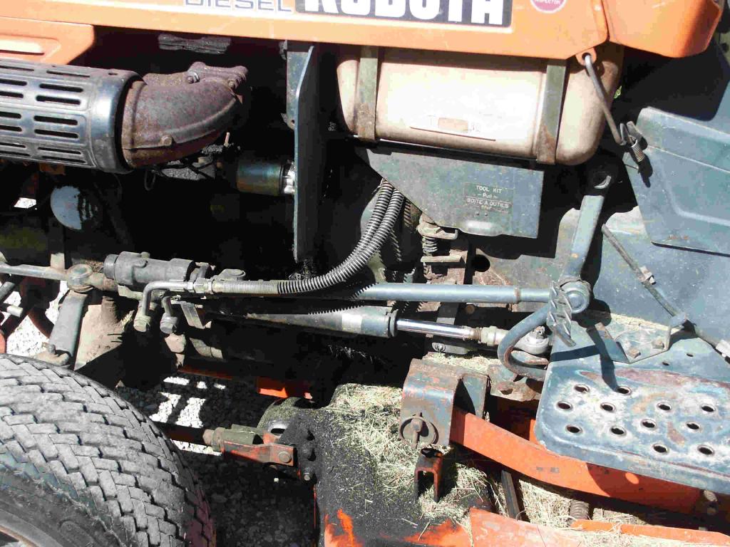

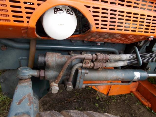

Pictures I found that I was able to attach. Same valve/actuator assembly as I have. My return hose goes under the left floor board and attaches under the seat while the pressure line snakes under the tractor to the other side and connects to the new hydraulic block. This block went under the existing hydraulic block and both were attached to the tractor with the supplied longer bolts. Still trying to find the instructions that came with the kit.
A shame that this kit is not still available as most folks that I know with these tractors would like to have power steering especially with loader work and turf tires. When I installed it on my tractor it was after digging out a basement where I had to do considerable maneuvering in a small area and my shoulders were 30 years younger than they are now.
