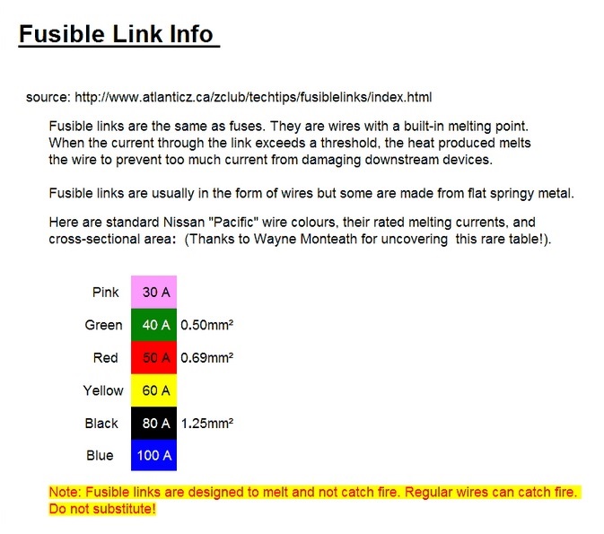

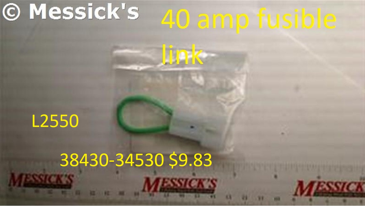

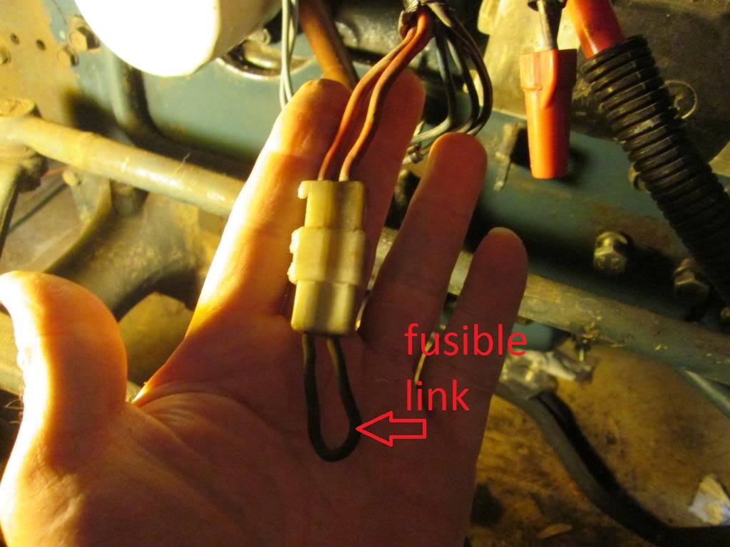

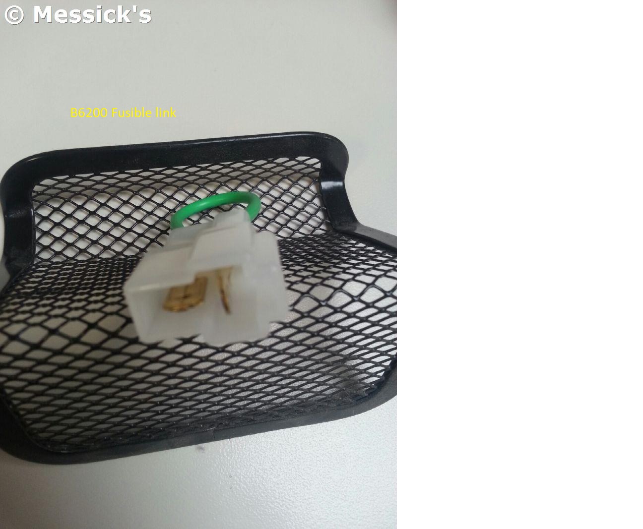

Your tractor should have a fusible link, likely green, at the starter. Check that one is there and the wire of the link is smooth and without any bubbles.
The fusible link is an early form of slow blow fuse. It is there to protect the entire wiring harness.
The fact that you can have wire terminals melt concerns me as it may indicate the fusible link has been removed and not replaced but jumped.

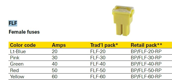

More modern tractors use a SLO BLOW fuse instead of a fusible link.
The performance issue is that the circuit needs to tolerate an overload for a short time before blowing. Regular fuses cannot do that.
The Slo Blow fuses are readily available. However, the holder is hard to find as it is part of the vehicle and rarely needs replacement so suppliers dont carry them.
Typical Kubota fusible links are Green which is 40 amp.
The slo blow fuse follows the same color convention.
Try a Google search for Busman fuse catalogue. It may put you on the track for the fuse holder. However, check local auto supply places first as my knowledge is out of date
