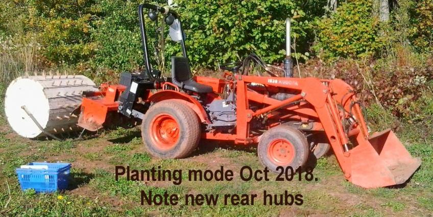

Again thanks everyone, these new hubs solved my problem. I spray painted them Kubota orange as soon as they arrived, and installed the next day, using the original stud nuts which almost look like new (with fresh paint on them)!
Total was US $348.60 including $86 shipping, which translates to about $450.00 CDN by the time they got here. Probably the most I have spent on this old girl since the new Hydraulic pump 3 years ago. I have no complaints about this machine she is a work horse for me. My next project will be new industrial tires (after 35 years my turfs are pretty thin)
Yesterday, I planted over 5,000 mature garlic cloves and was even able to remove my coat for a short while. Not bad for mid October on PEI. If the weather stays like this I hope to get about 12,000 more planted before frost, then cover them with leaves and straw for the winter.
