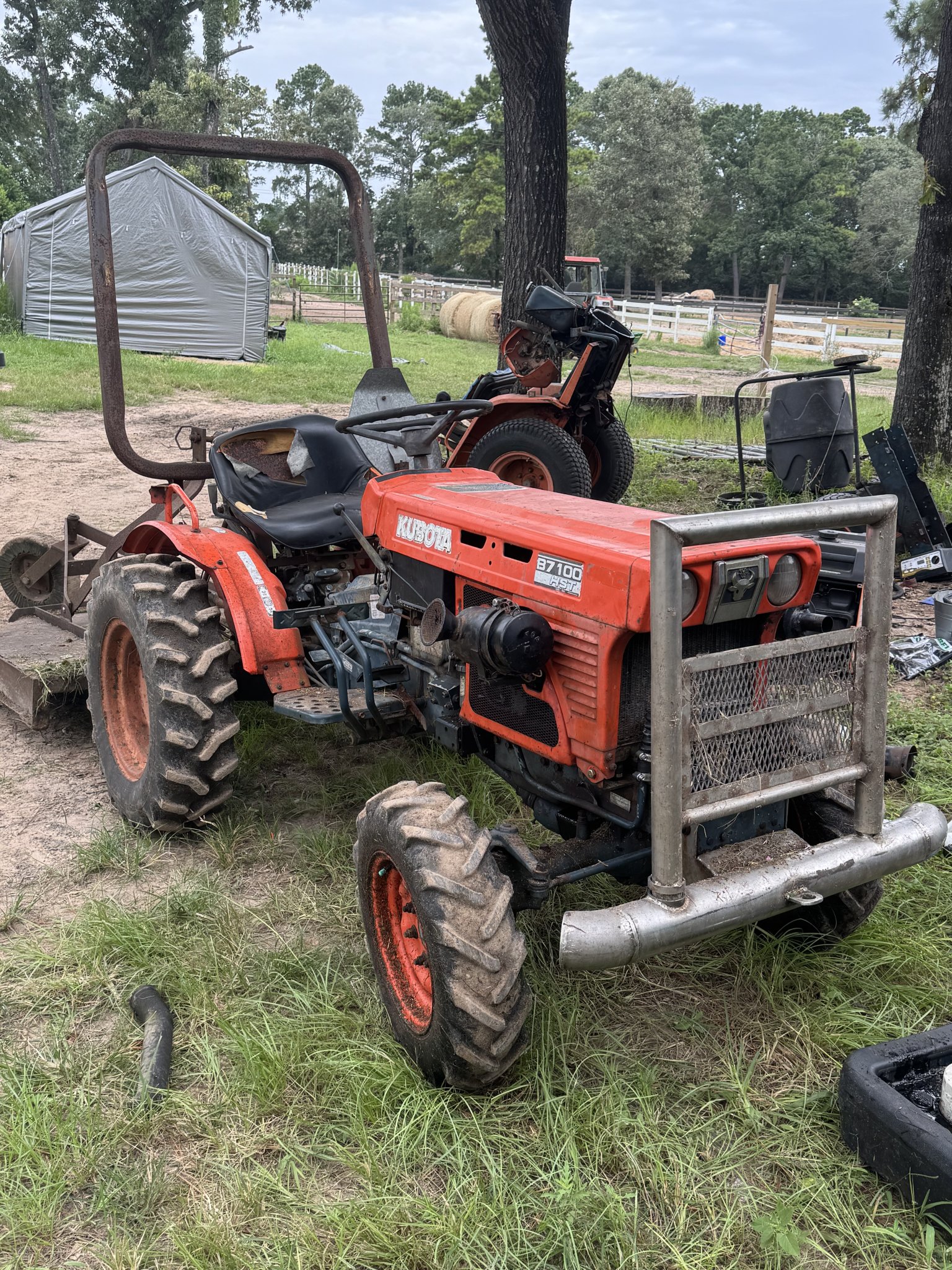

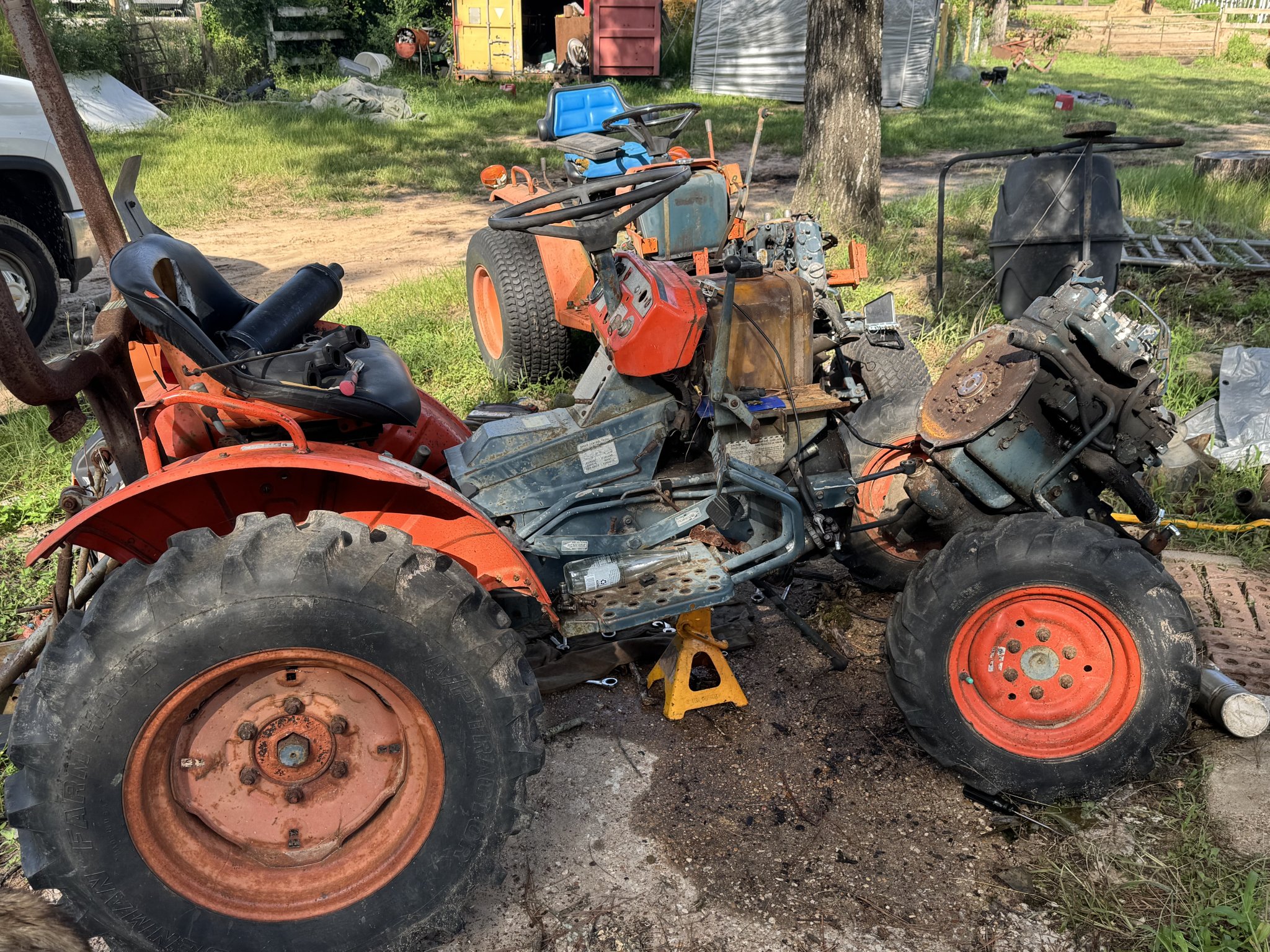

Welp, my d750a had a lot of blow by and smoke, now it won’t start. Picked up this b6200 With a d850 because the engine ran on the first crank, but the 3point won’t lift. Figured I would throw the engine in the B7100 and be done with it, but I really like the longer frame and would love to use this front pulley to mount a hydraulic pump to run various accessories. I have to use the old radiator because of the two hoses on the bottom and the smaller hose on top, so using the longer frame would make that easier as well. Only problem I think I might have is the 4wd shaft to the front Axle may have to be longer.
Any advice or opinions are welcome! Wanting to make a better, more useful machine, not staying original. I definitely want to use the b7100 hood though.

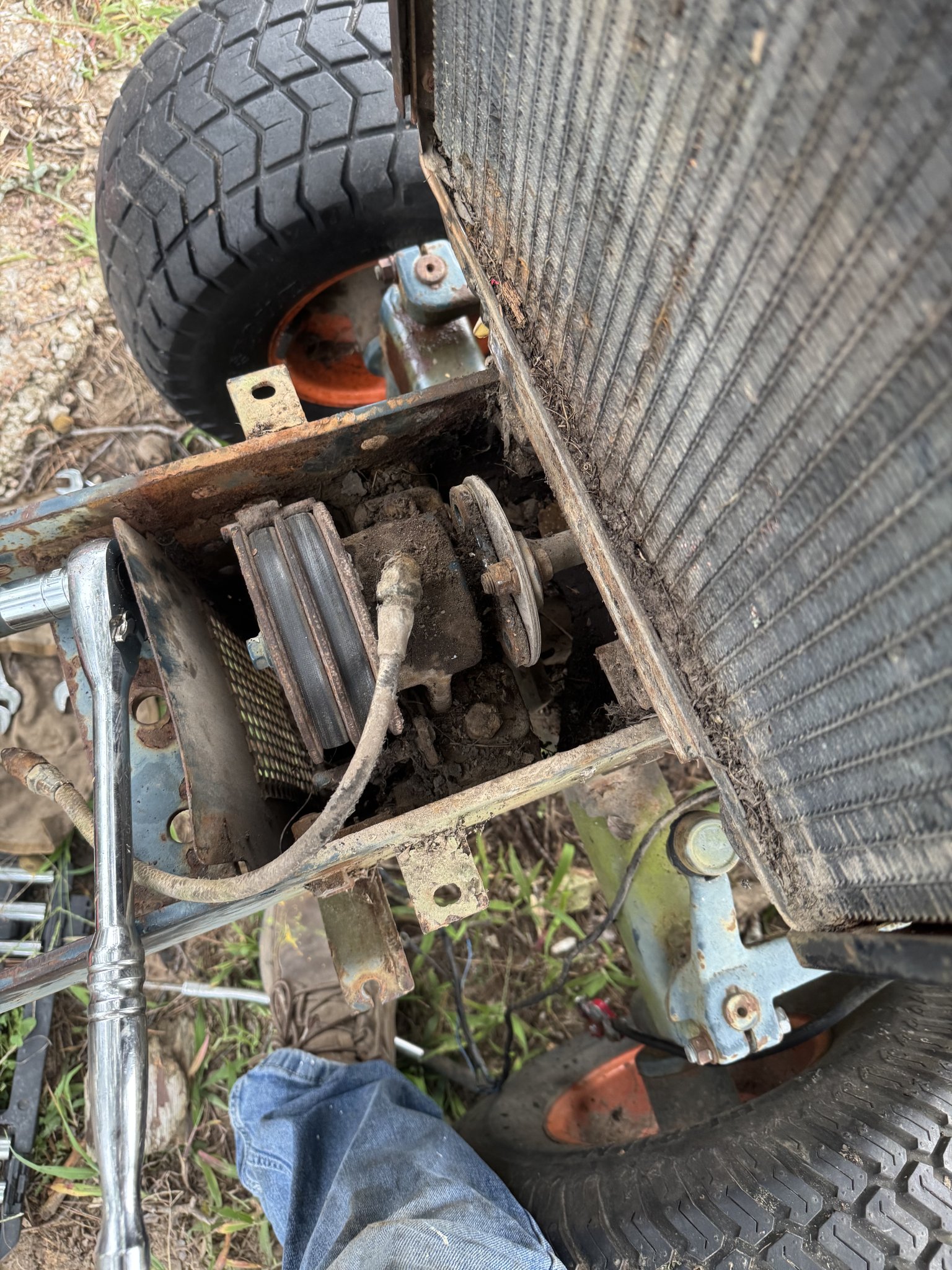

Cool front bumper. Liquid filled?
Saw a similar design (except square) on an old ford scut, & that was filled with lead shot.
6,466
2,083
I’m impressed by the radiator and the bumper!

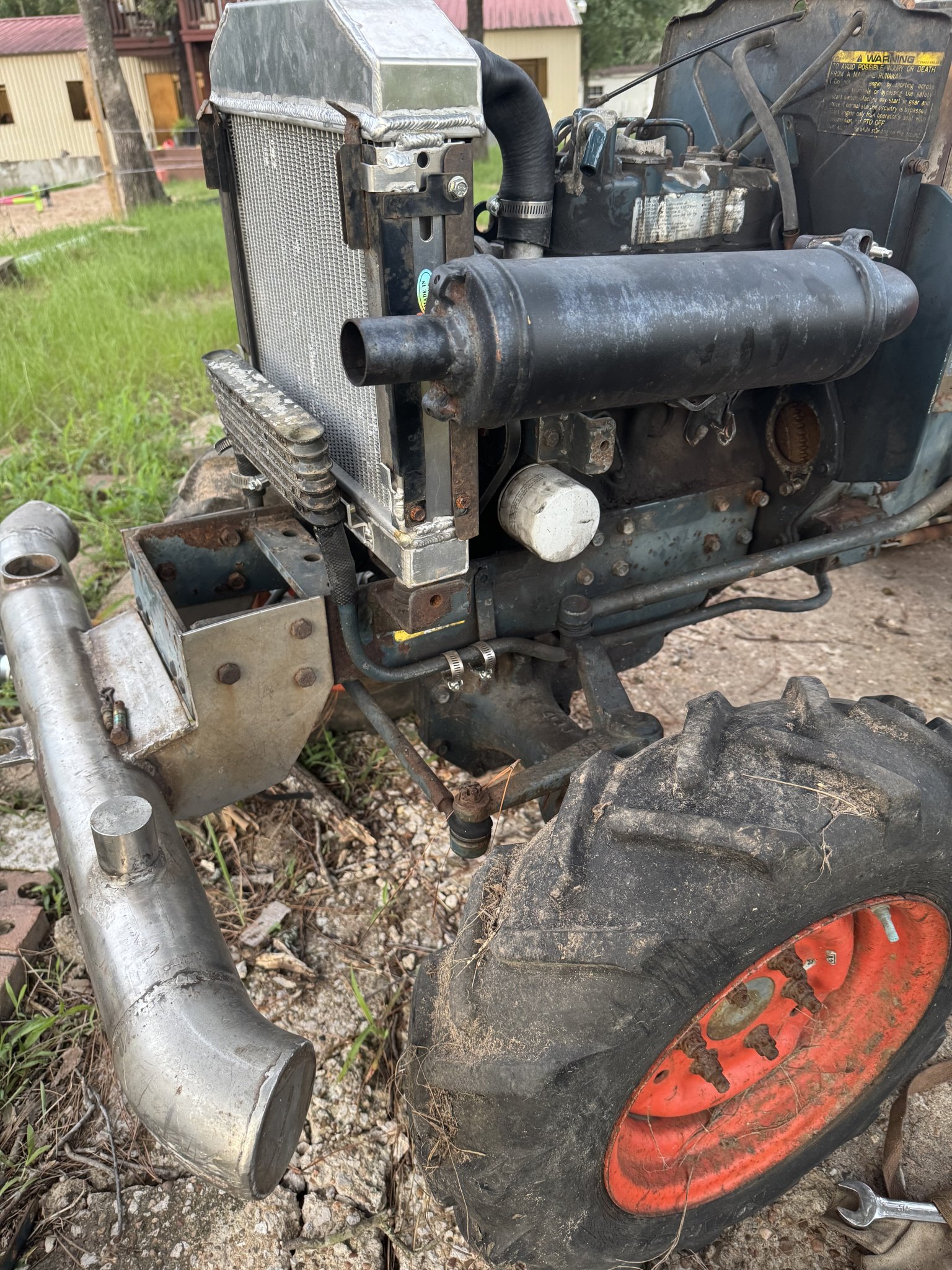

Unfortunately, that radiator won’t work on the d850. I am going to completely rebuild the D750. I might put it on an engine stand to run it all together and then store it for when the D850 wears out, or I find an another nice b7100 to actually restore.

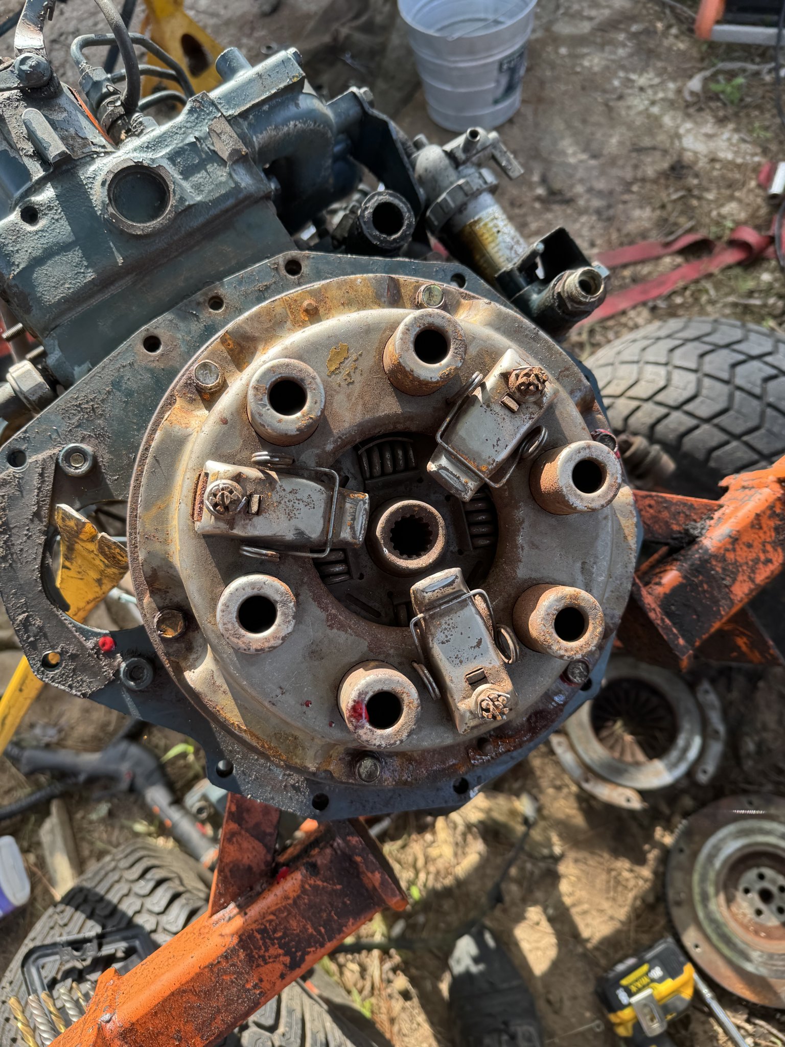

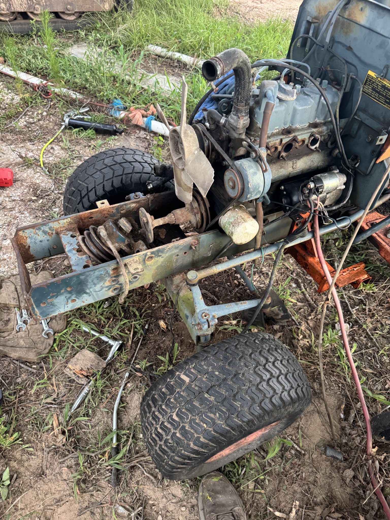

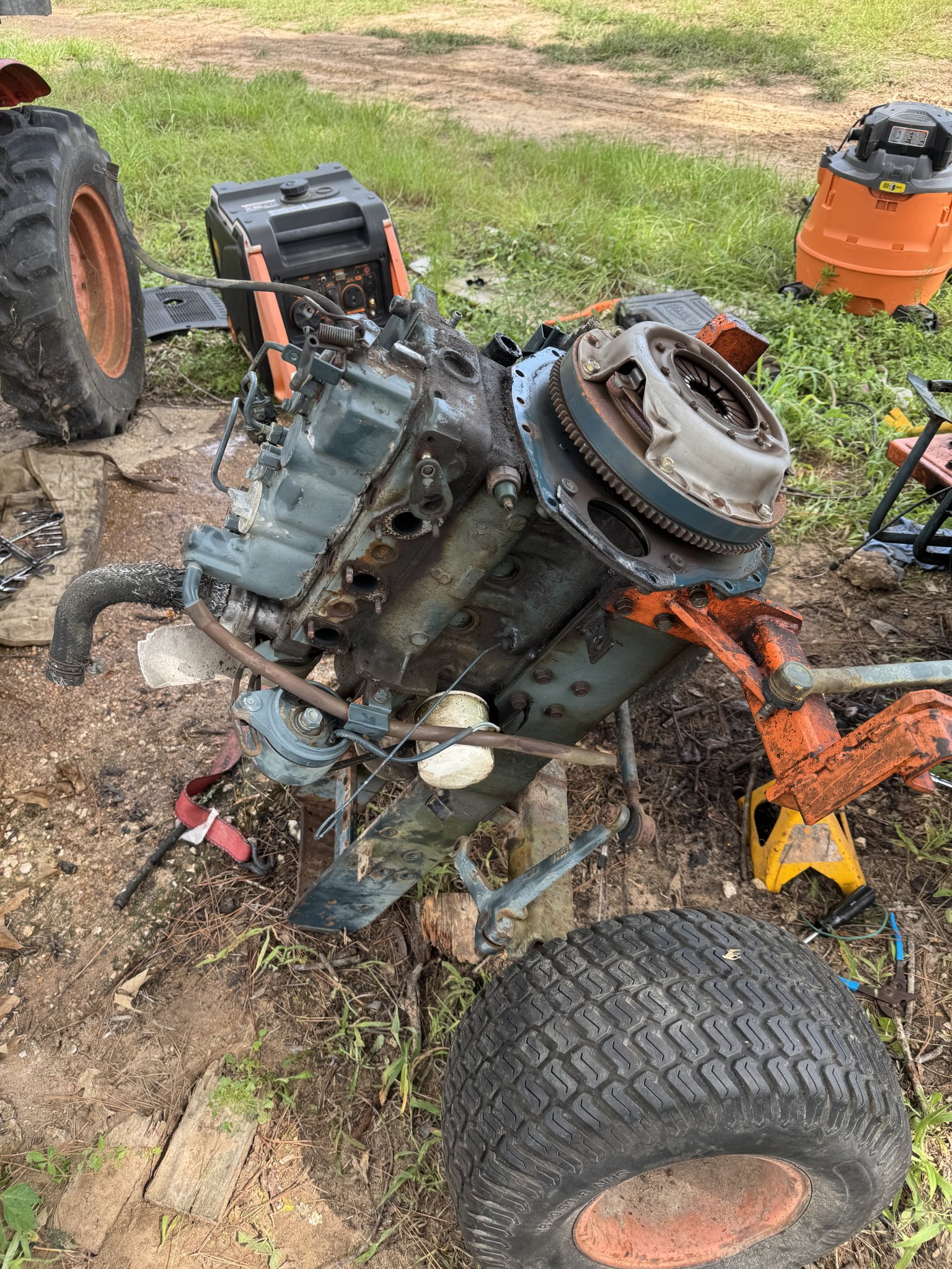

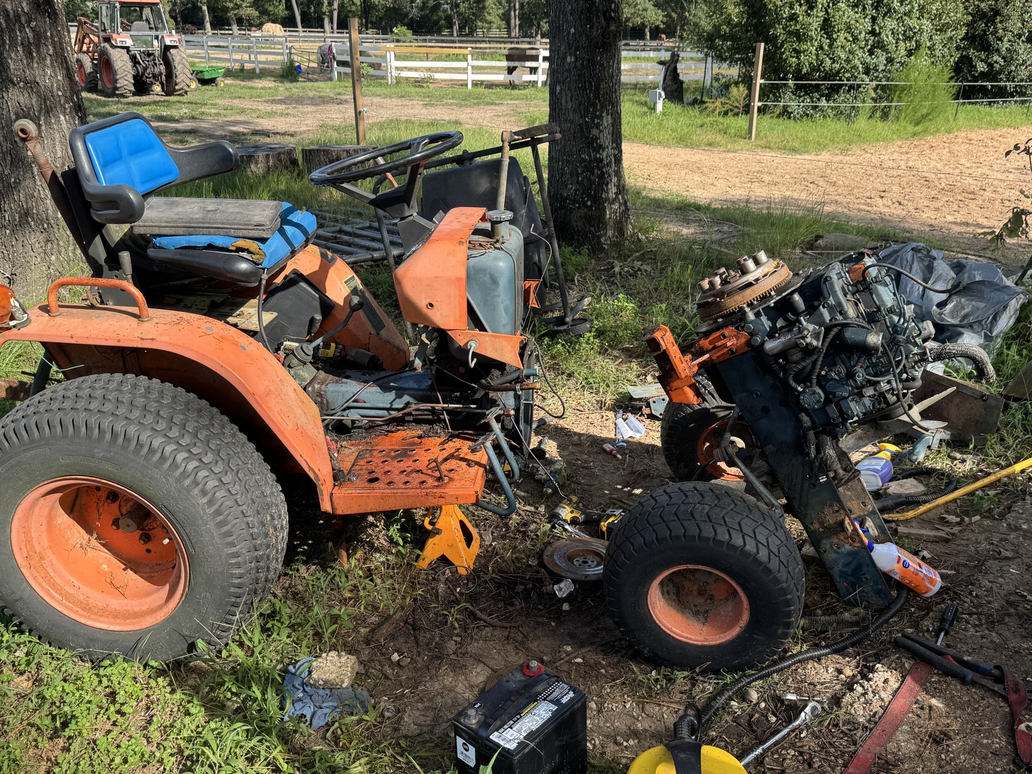

Well, I got the d750a swapped out with the d850. After cleaning this engine up, and looking up numbers, it is definitely a 20hp.
I used the original frame from the b7100 but I could have used the longer frame from the b6200. I decided if I wanted to modify, I will just cut and weld.

I am going to have to weld on the tabs for the d850 radiator but that is the only true modification I have to do.
