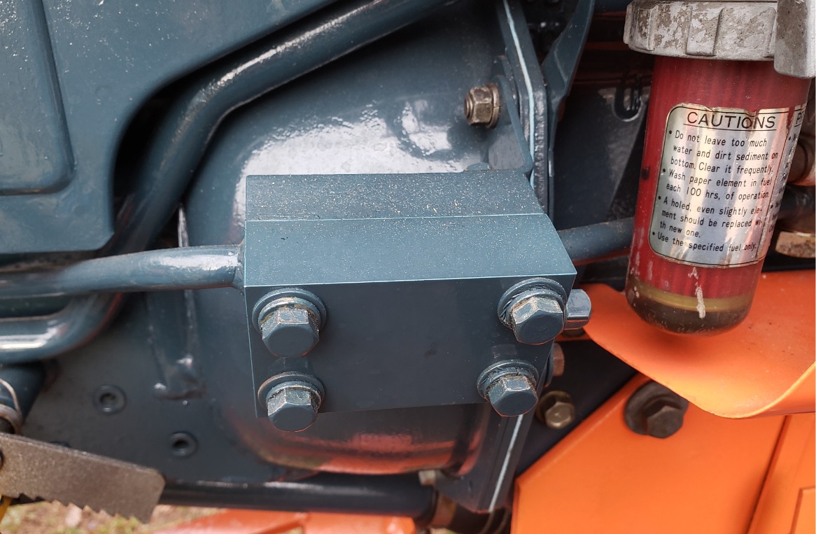

- Bypass block for hydraulic connection - used while dozer hydraulics are not installed.
