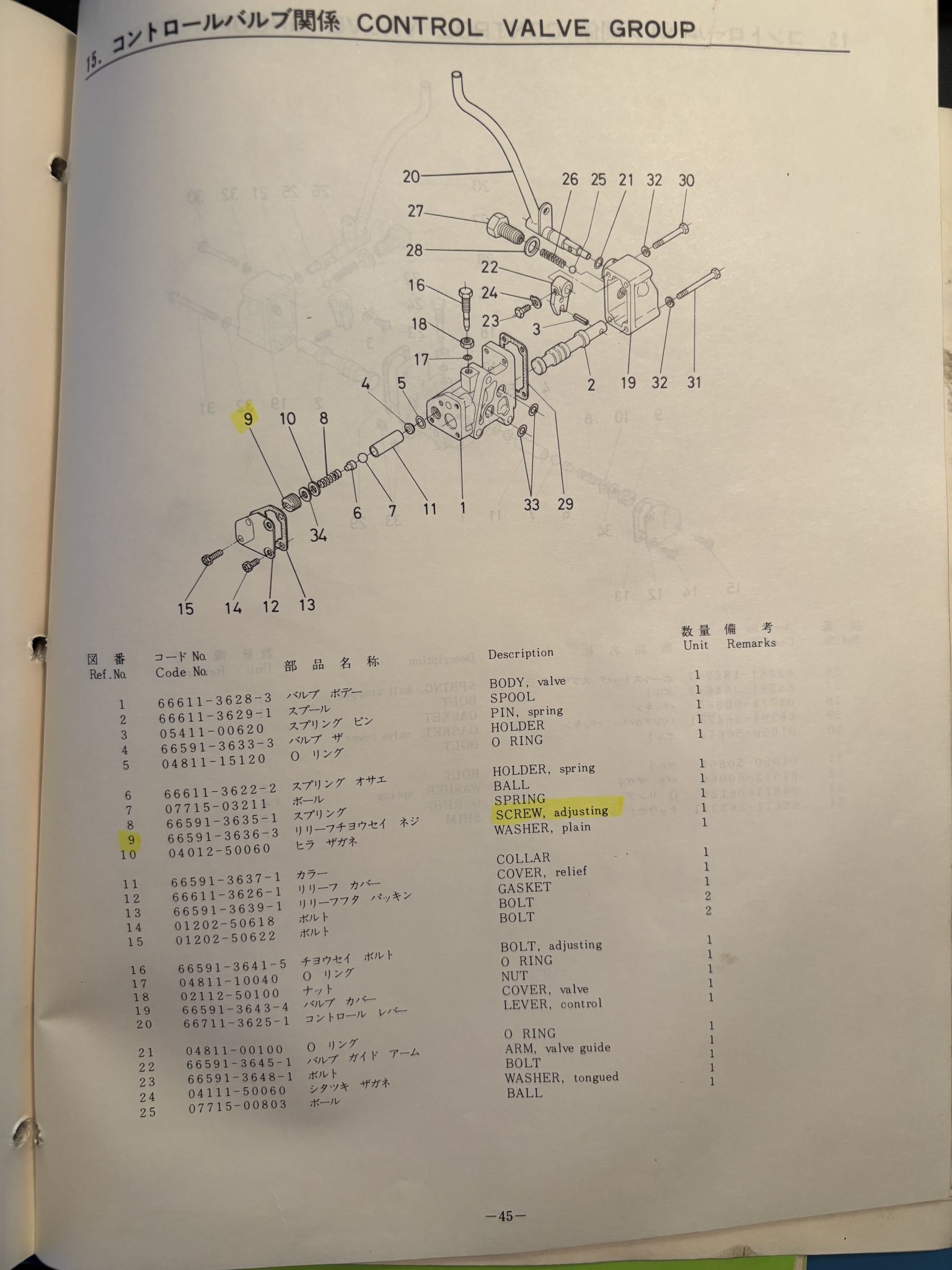

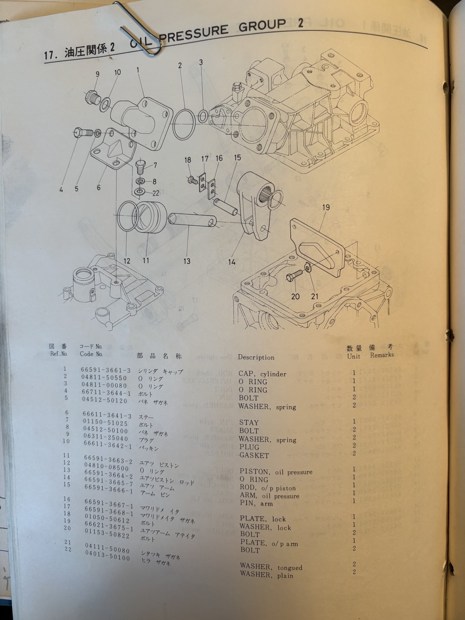

There is no hydraulic cylinder, only a hydraulic control valve shown on page 45 of the original parts manual. There is a "spool" (part #66611-3629) operated by the up down lever which must direct hydraulic pressure from the pump mounted at front of tractor. The control valve parts diagram shows an "adjusting screw" (#66591-3636) accessible from a small removable cover. It must increase/decrease spring (66591-3635) pressure, but it's not clear what affect that has on the implement hydraulics.
See attached parts diagram for "control valve group"
The "spool" is the valve and it operates a hydraulic cylinder.
Close the lowering control valve and see if leakdown stops.

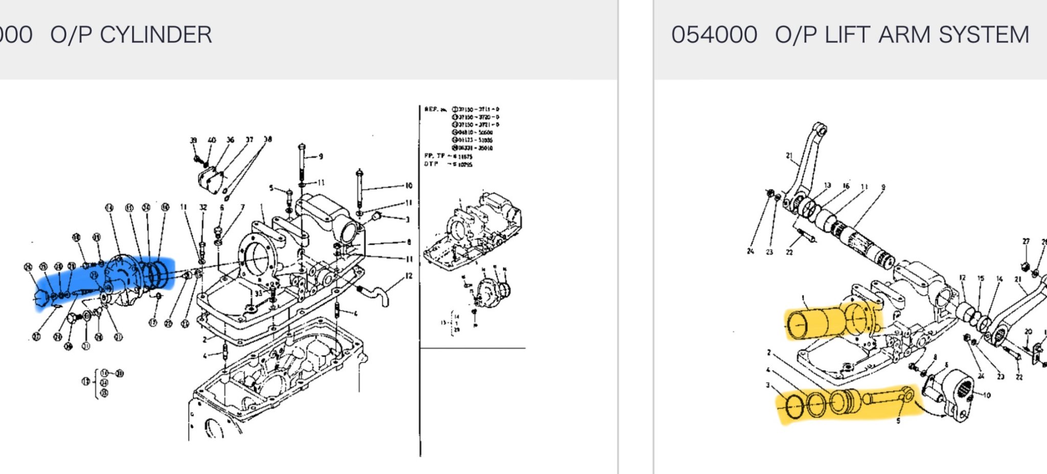

@rcsroper
The 3PH cylinder is inside the tractor, not an external hydraulic cylinder like on a front end loader
You can find it in the illustrated parts list that is available here
Here is a screenshot of the parts on my L185 since the similar diagram for your tractor was less clear than these two. The blue shows the speed control apparatus that is over the cylinder that is in the yellow. The piston goes into the cylinder (but is pulled to the side for illustration purposes).
So you think the three point moves via magic pixie dust? :p :ROFLMAO: :ROFLMAO: :ROFLMAO:
DO NOT open up the control valve and start "adjusting things" that not your problem, and no good will come of it.
The valves rarely have any issues and they rarely have any issue with the three point drooping and drifting.
The drop speed adjustment is external so no need to open it up and go searching for it, it's right out in the open.

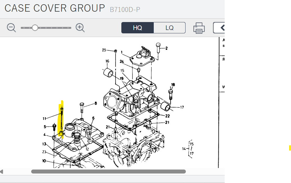

@Russell King has the right idea but let's clear this up a bit.
This is a B7100 three point cylinder and piston and rings.
There is no drop speed control on the cover it's on the valve.
