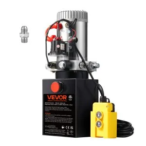

I just saw a 12v hydraulic pump assy on vevo it was 3000 psi I believe first thought was could it be used for a front hydraulic supply
Post a link but I am skeptical.
No you don’t you sound as hard on yourself as I am on myself 👍. There’s a bunch of different ones on the site

The pump may be capable of generating 3000 psi, but that doesn't mean it's a good idea for your application. Aside from the pressure ratings of the other components in the system, the engine may stall if it can't produce the required horsepower.
You can still use that pump; simply set the relief valve to the lowest common denominator.
