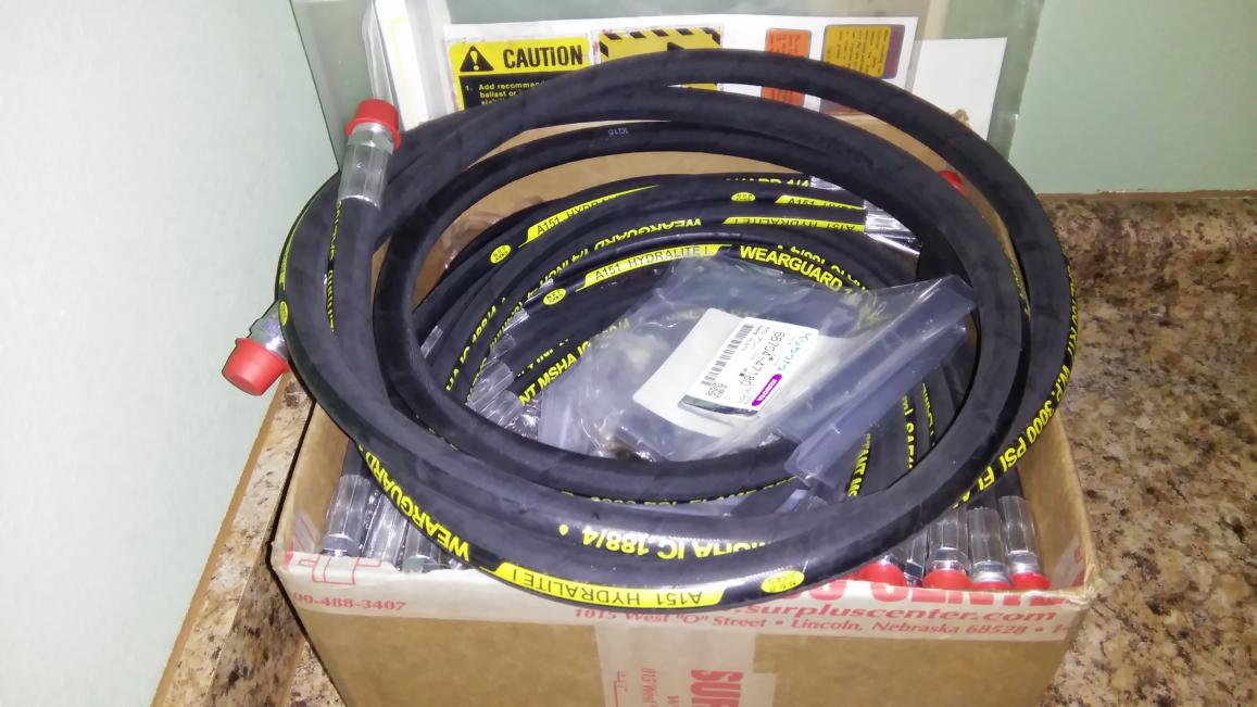

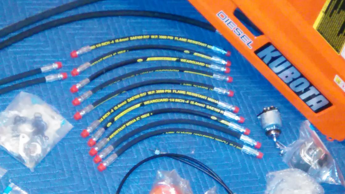

Alright, I ordered new hydraulic hoses and some fittings. They sent me 3/8 hoses instead of the 1/4 inch lines I wanted. Sent the parts back and waited for the correct replacements to get here.
I received those lines today and now I have the correct parts. I've got everything set out and ready to go.

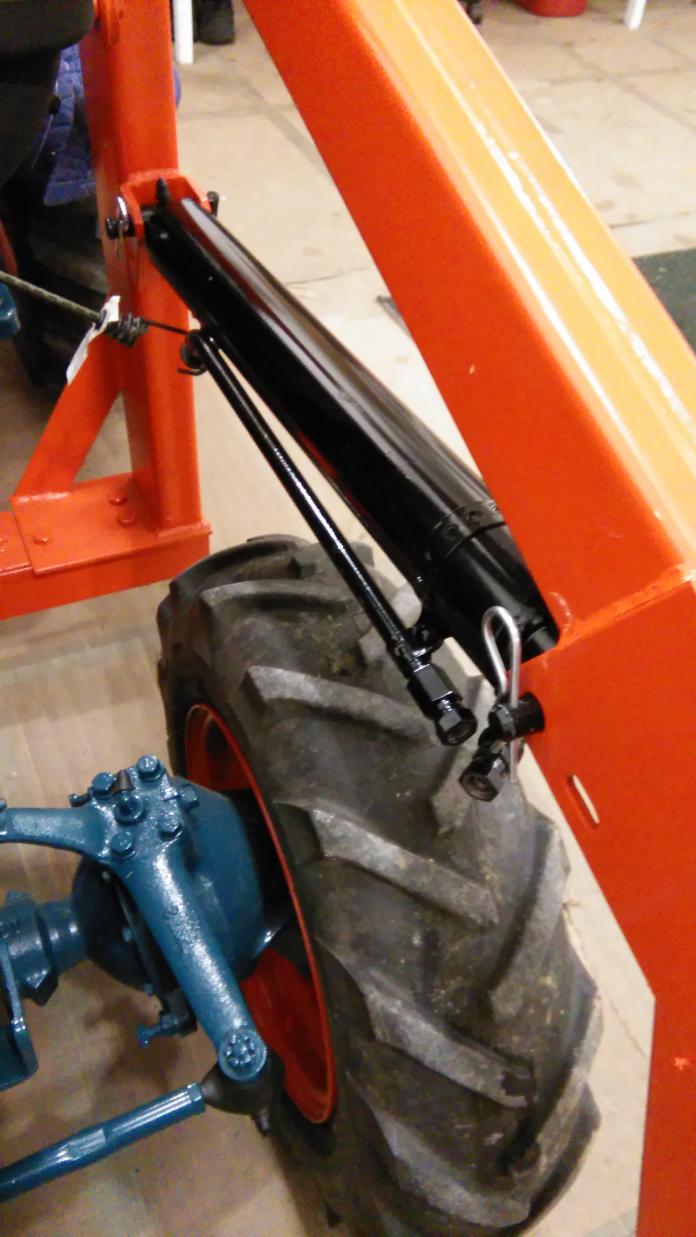

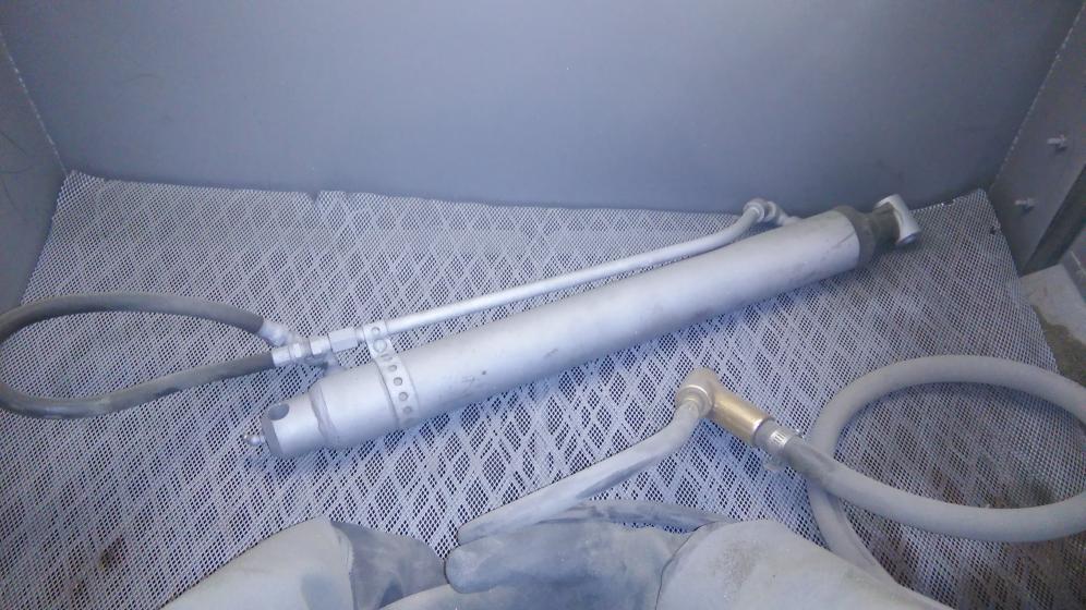

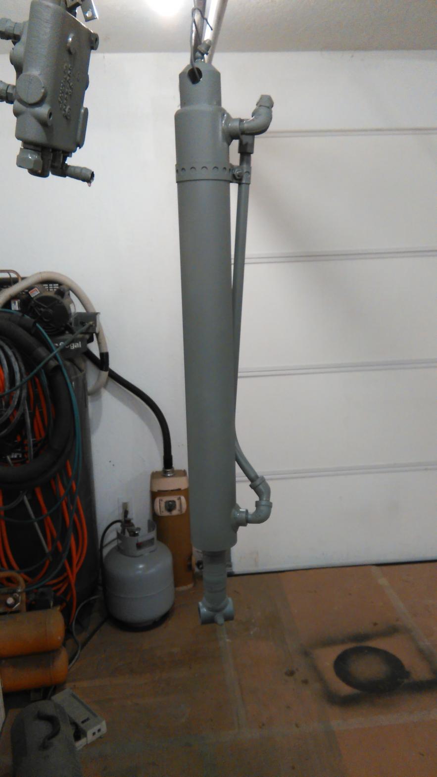

While I was waiting for parts I spent some time cleaning up the hydraulic cylinders. Only 2 are complete and mounted on the loader frame.

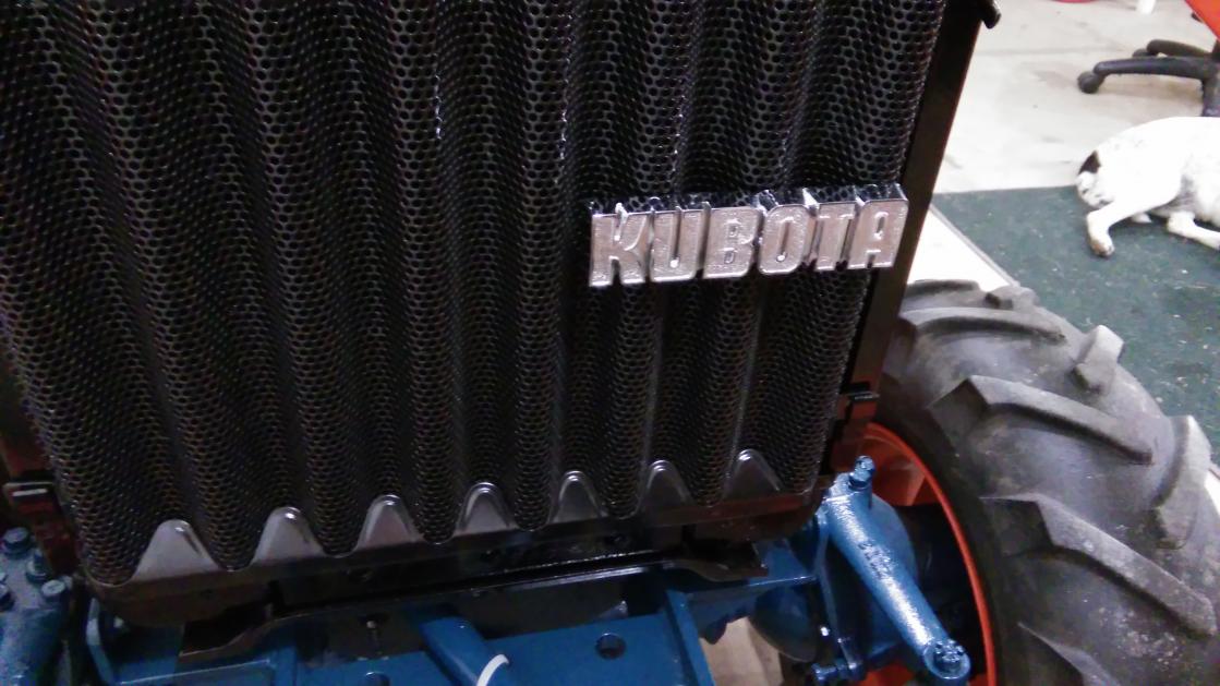

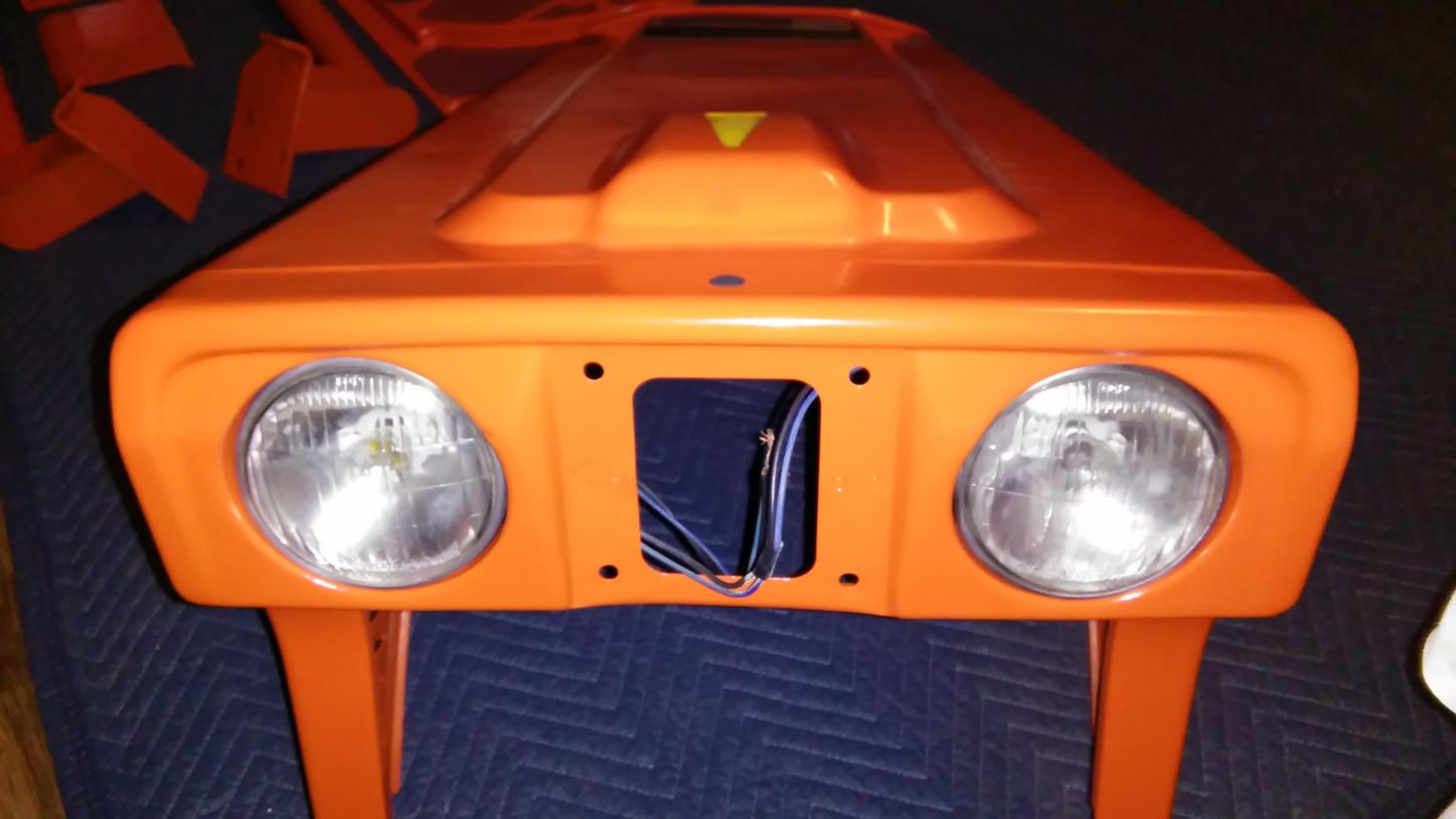

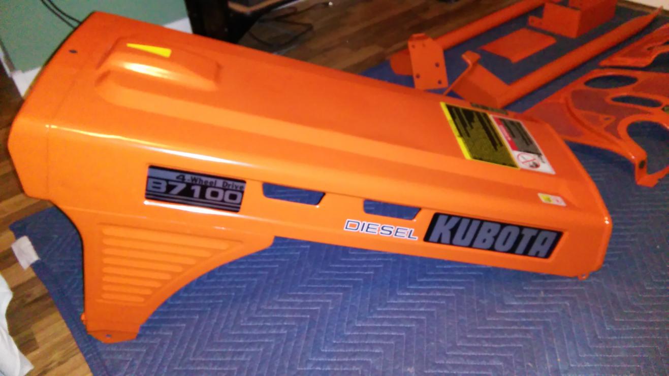

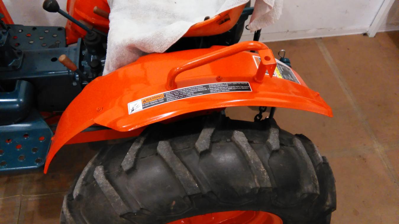

I also spent some time putting decals on the hood, fender and one side panel. I ordered the chrome Kubota emblem that mounts on the grille, $44 bucks ouch. The emblem that goes between the head lights was $66 and some change.

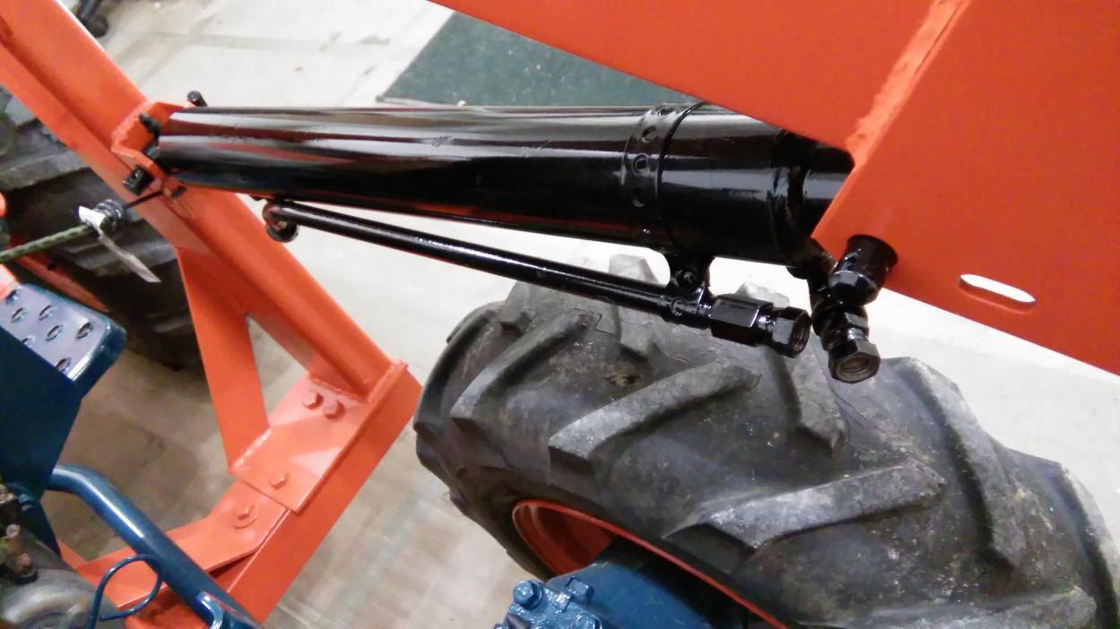

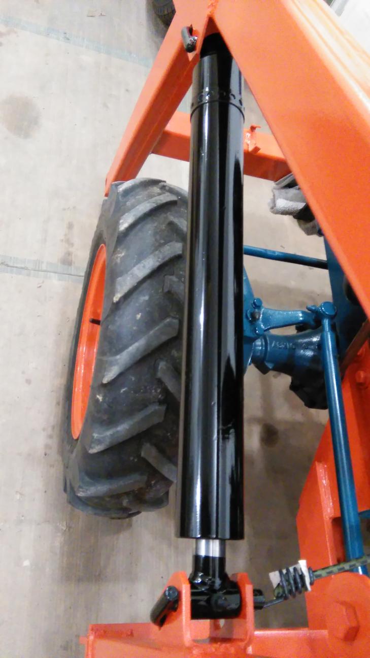

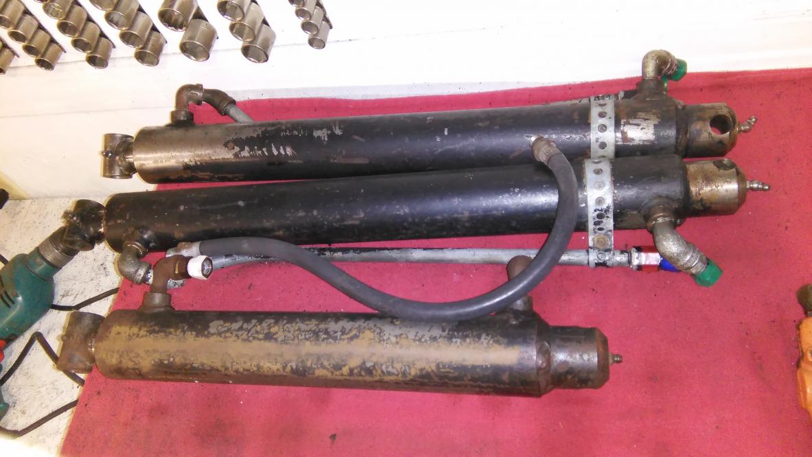

Alright, here we go again. I've posted pics to my last reply on page 29 and I'll pick up where I left off there.

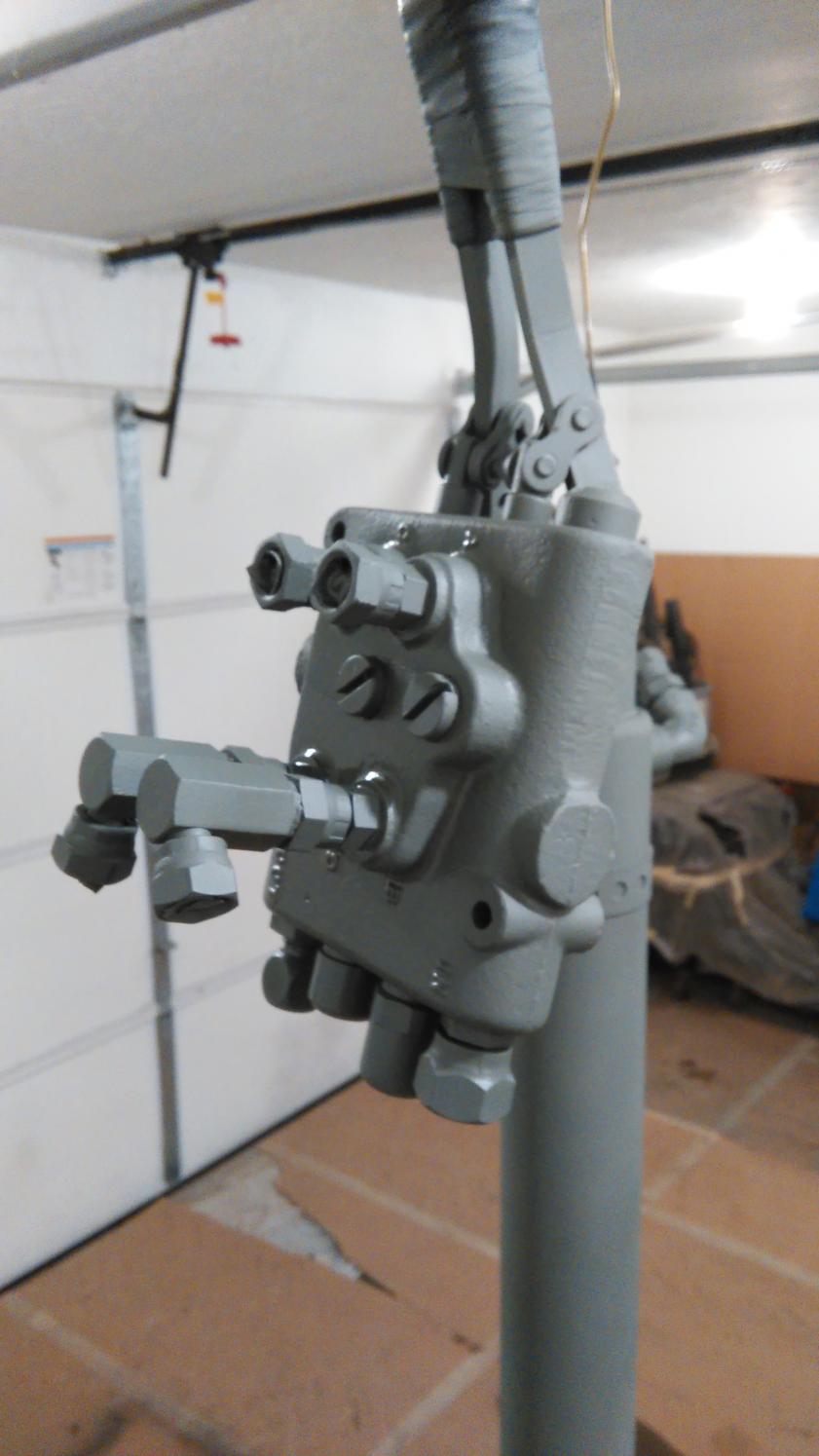

So this week I've managed to finish up the last 2 hydraulic cylinders and the loader control valve assembly. I'll have my dad paint the valve assembly this weekend.
I've also been working on cleaning up the steel lines that fasten to the loader frame, they are turning out better than I thought they would.
I'll catch up on posting pics as I go.

And the last batch of pics I'm going to post up until I get more done after the weekend.
