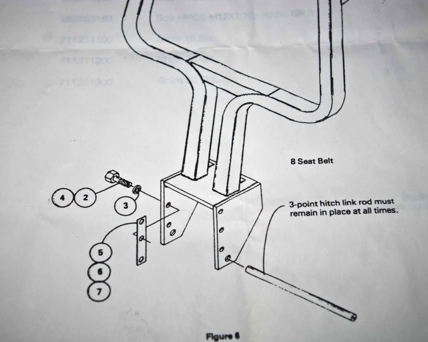

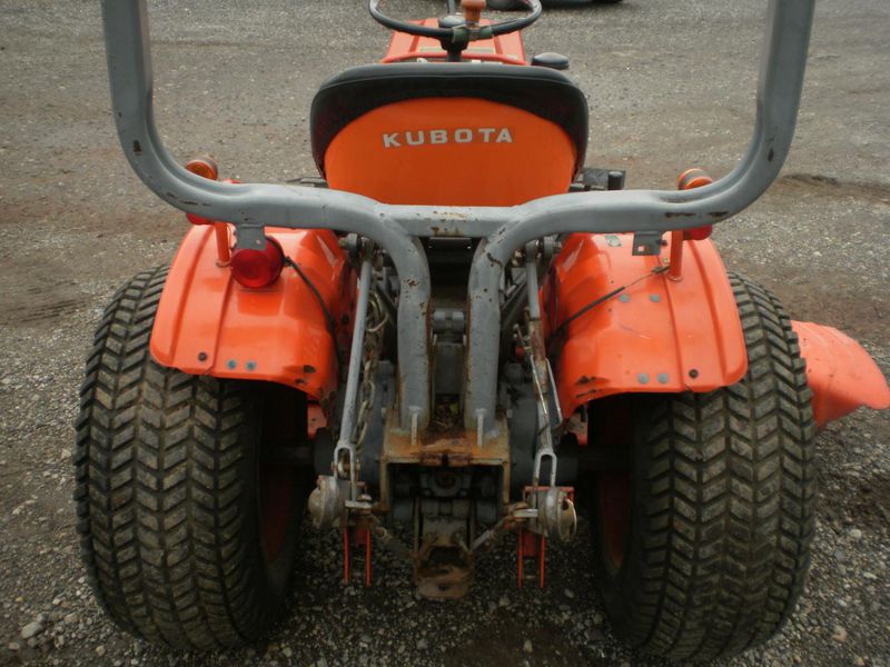

B7100 ROPS mounting
7,437
2,801
I recall that the top link mounting (angles) was removed and then the ROPS was mounted directly to the case. Long studs were threaded directly into the tractor, ROPS mounted on studs, three point angles mounted on same studs then washers and nuts installed to clamp it all together. But that was on a L185, not a B7001.
Hope that information helps!
Many thanks for that, I'll have a look.
