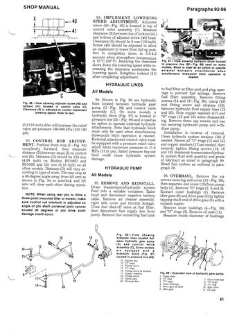

First pic shows the filter screen- essentially a big banjo bolt the holds one of the hydraulic pipes on.

3rd pic shows controls- sounds like you are asking about the 3pt hitch lever- it should not be locked up.
Sounds like you need some manuals…..

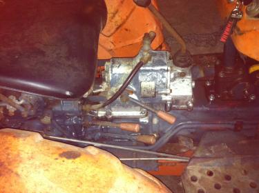

Nope, not the three point hitch lever. This one is just above the high/low range lever on the transmission. If the picture loads it is just under the black hose.

And thanks for the picture Lil Foot, but the lever I am talking about is not listed in it.

You can get all 3 manuals (operators, service, and parts ) from Kubotabooks.com, If it's down try it at the first of the month.

Big Kahuna got it….. see how pics help? How about the screen (lower right side under the floorboard) & directional control valve under the seat? Maybe the plumbing on yours is different because of the creeper gear transmission?
