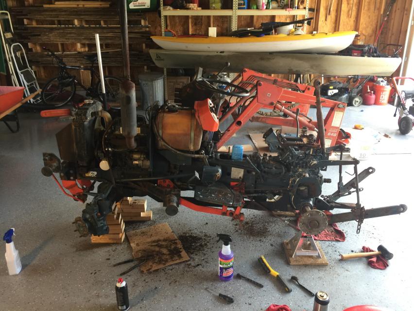

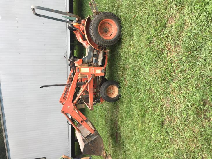

Changed fuel, fuel filter ,charged battery and a little starting fluid. It fired right up. It sat in the container for over 2 yrs. Now I have it home in the garage. Power washed, took it apart some, and gave it a good cleaning. Can't decide if I want to keep the original paint or repaint it. Any suggestions? I don't know if I attached these pics correctly or not. Thanks for your help!

As for the pictures, they are attached, but need to be surrounded by img tags instead of url tags. See the yellow icon of the sun over a mountain? That's the image tag icon for embedding the images. When you use it, the post looks like this:
(you could rotate the first one too. Then the optional vertical exhaust pipe will actually be vertical!)

"took it apart some" Ha Ha if that is "some" then you are hooked bad. Most make it about six months before showing signs.
Seriously, a little patina on a tractor is a good thing. Never afraid to work it hard because can't tell if that is a new scratched or not.

It looks like you have the upgraded rear hubs. Nice, one place the previous owner has saved you money.
