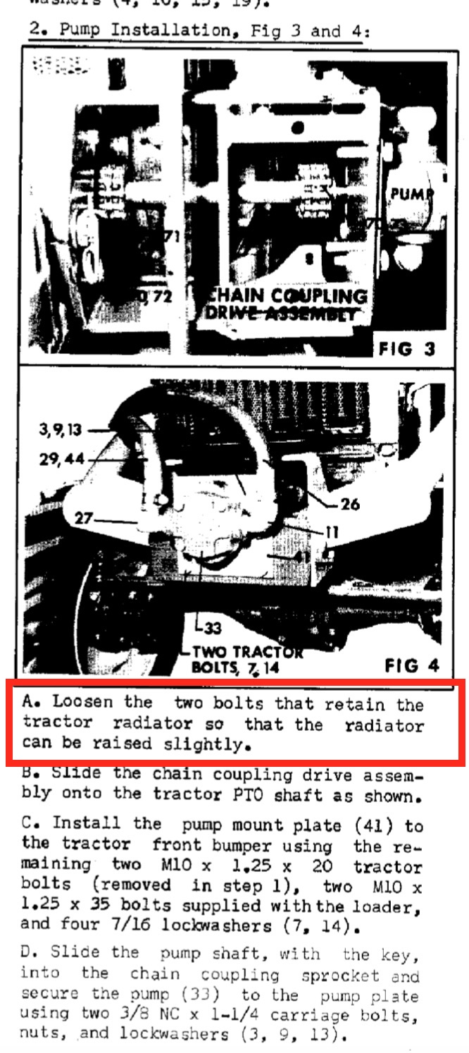

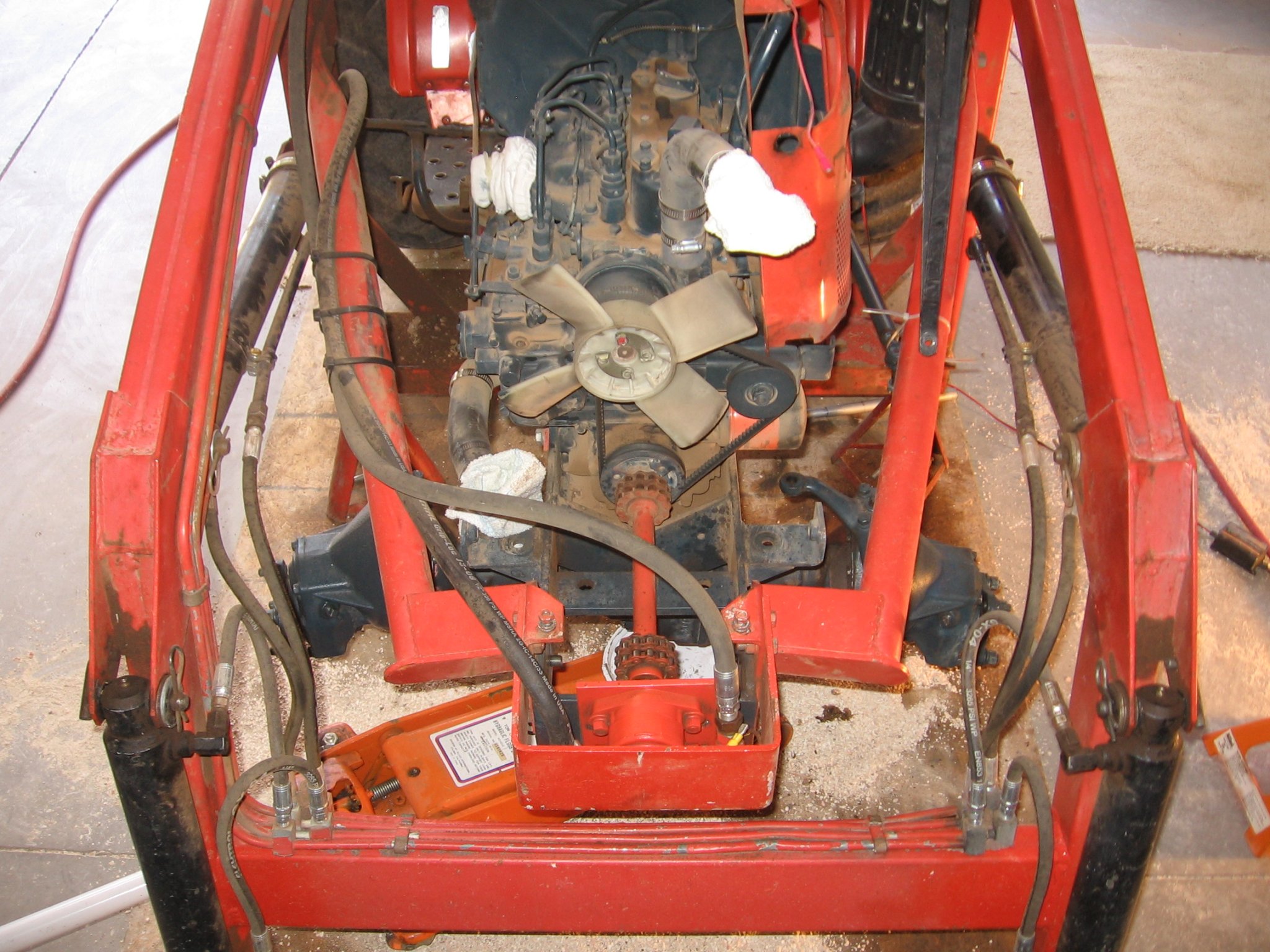

Working on my b7100 with a kubota unknown model from end loader. Mine has a splined shaft that goes on the bottom crank shaft. My question is, do i have to take the radiator out or moved up just to put that shaft on the splines. I don’t really see another way to install?
The other end of the shaft has a gear that matches with another gear to be tied together with a chain to spin and believe to make the hydraulic work for the loader.
where can I find a illustrated drawing of this unit to the b7100 and parts list?
