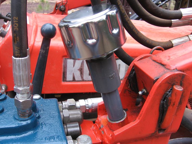

Just about any 1/2" NPT breather cap will work, like this:
http://www.northerntool.com/shop/tools/product_200466920_200466920
Mine was missing completely (rag substituted) so I just made a new one with PVC fittings, SS screen, & AC filter material- in fact I made a second one for my B670 backhoe. (also rag substituted)
A couple of pics of the backhoe cap, not great pics, but enough for an idea of what we're talking about:

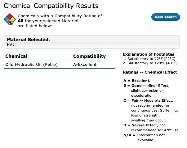

A couple of chemical compatibility charts:
Your right, Charlotte pipe specs even say it does but only at a max temp of 73 deg F. I would have never guessed it was ok seeing that my code tells me not to. If I piped your oil tank to your boiler in PVC, an inspector would cut my license up lol, but Charlotte pipe says fuel oil Is comparable up to 73 deg. My question is....after 73 deg, what happens?
Apparently nothing- I've run the tractor in 110 F ambient temp, let alone how hot the oil & tank got during use, with no effect.
I suspect the difference may be related to the fact that fuel oil is more solvent than lube or hydraulic oil. I've been told that fuel oil is similar to diesel, and I've washed parts in diesel with good results, but washing parts in motor oil wouldn''t be very effective.
I also have some kind of pipe dope/sealant around here that has a caution about not using it on plastics. Again, I suspect that that is due to aromatic solvents that evaporate as the stuff cures- the dope itself is probably pretty benign once the solvents have gone, but they're worried about those solvents softening (or worse) the plastic.

After rebuilding the cylinders on by B219 loader, I was filling the oil tank (with oily hands) and went to put on my homemade PVC breather cap, (also oily) it slipped from my hands, went flying, hit the concrete floor, (garage temp about 32 degrees F) and snapped off the threaded portion. It was not repairable, and I was 150miles from a major city, but only 50 miles from a small city. Off I go, & I found a breather cap at NAPA with the correct thread, but a larger outside diameter. I needed to use the tractor, so I bought it & added a PVC extension so it would clear the FEL arm. It works great, so I'll use it until I can find something that fits better.
It was $13 & change.
They also said they had the same cap with a 3/4" NPT, which would fit the B670 backhoe.
