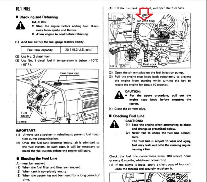

I too suggest new fuel.
Does your injection pump have the air bleed shown on the page attached?
Are you bleeding the injectors one at a time. Should not do all at once.

Hi all, thanx for all the suggestions. Yes, water is a possibility, as is algae. I've read on another site that I should drain the fuel tank, clean it, and put new fuel in it. (The fuel in the filter was a little dark)
I don't remember noticing the air bleed on the injector pump, but will look today.
Also, when bleeding it, I only did one line at a time, but didn't have the throttle on full. Will do that after I drain and clean the tank.

Hi all,
Well, got her started.
I drained the fuel tank today, and checked the inside of the tank. The fuel "looked" like regular diesel. The tank appeared shiny inside. Wiped along the bottom with a clean metal rod and a rag, there wasn't any slime on it. Pulled the fuel filter again, the fuel inside "looked" normal, but dumped it as well.
There was an air bleed knob on it, so opened it. Noticed one connection from the lift pump (?) was loose, so loosened the fuel line to the injector and tightened it. Then bled each fuel line at the injector, one at a time, at full throttle. Closed the air bleed knob. Used the pre-heat, turned it over and away she went. (YAYYY!!!)
Guessing old fuel, possible air lock from the loose connection on the one injector line. I also cleaned up and lubricated kill lever from the engine stop .
