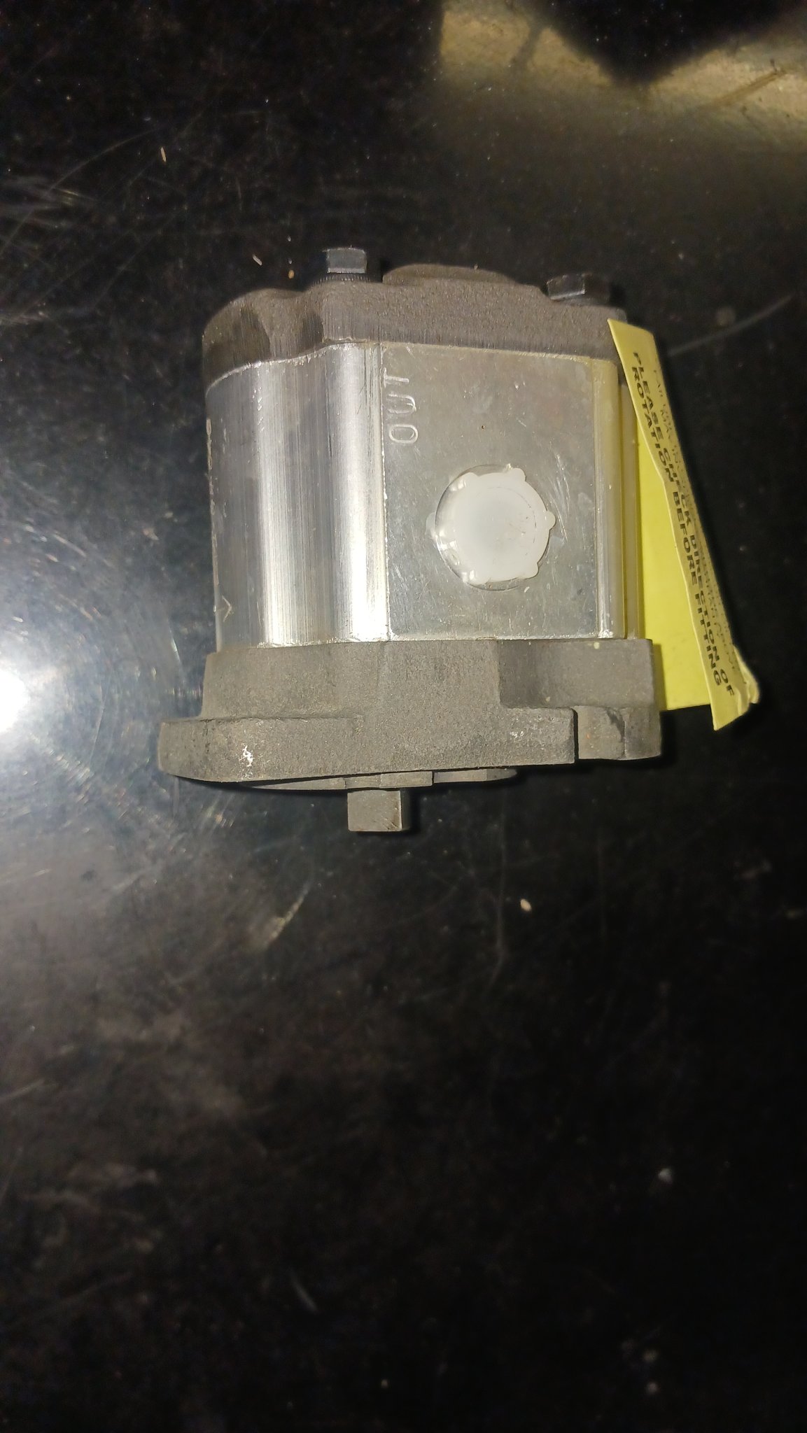

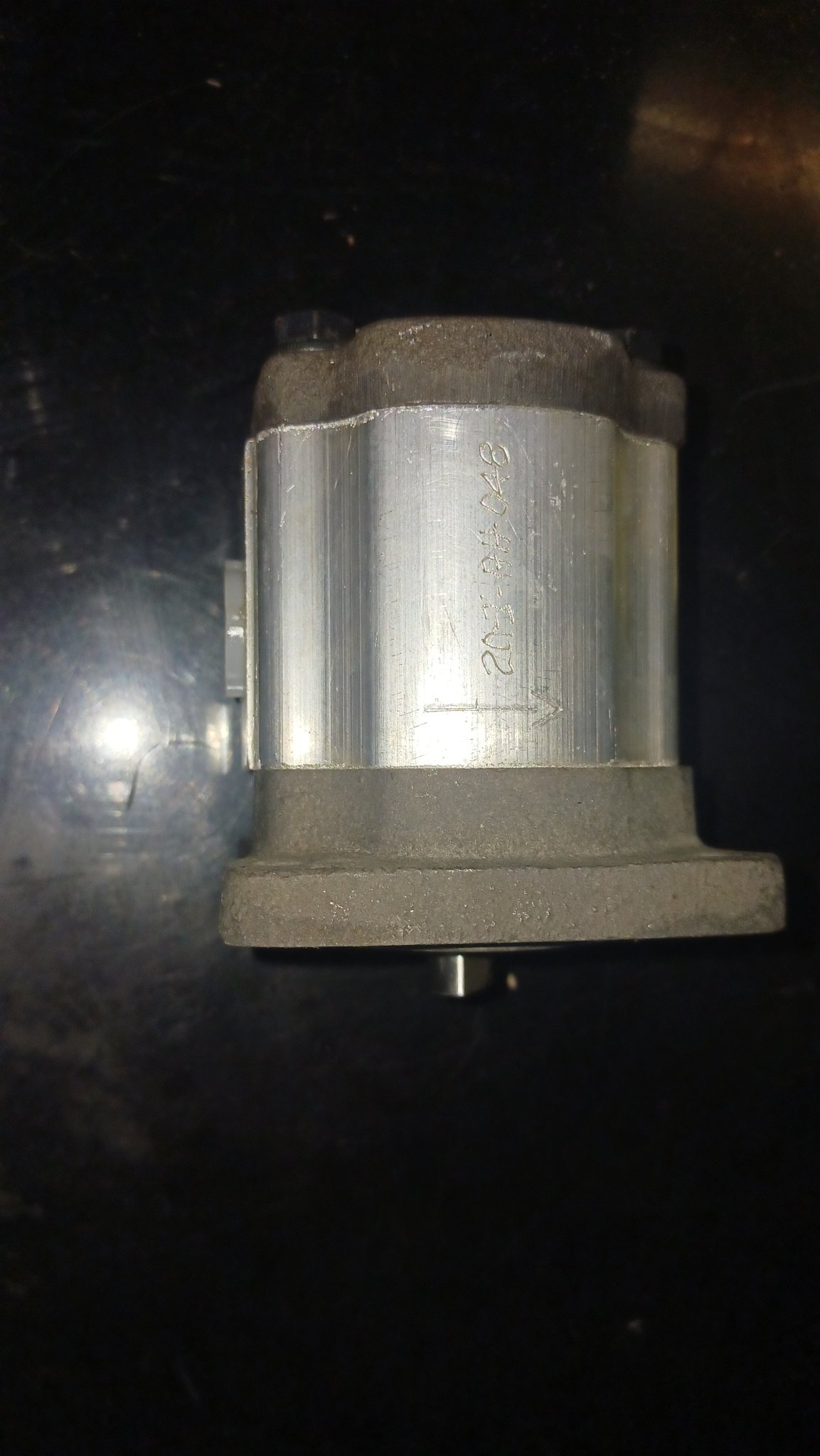

If all you are getting is 1700 PSI the pump is probably worn. Here is the fix.
