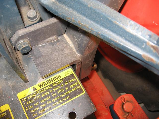

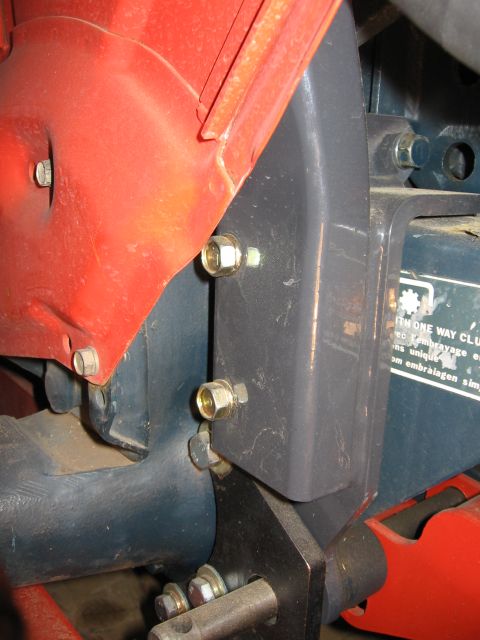

Thanks for the photos, I will replicate that fixing method as much as I can.

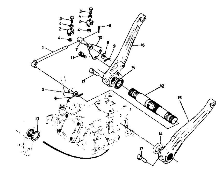

One question; on the right side did you have to do anything to the 3P lever "rod" that operates the valve? On my tractor there is very little clearance there and I am thinking of possibly cutting off an inch or so of it (that is unused) to make some more clearance.
Cheers!
Hasse
8,165
3,532
The dealer insisted I wasn't qualified to install my ROPs, so their "Super Tech" had to install it. He screwed it up, bending the 3pt linkage. After I straightened everything, all that was necessary for everything to clear was to turn part #2 (on the drawing below) 90 degrees to clear the bar. Here's the link to the post:
http://www.orangetractortalks.com/forums/showthread.php?t=5328
Post #3.
