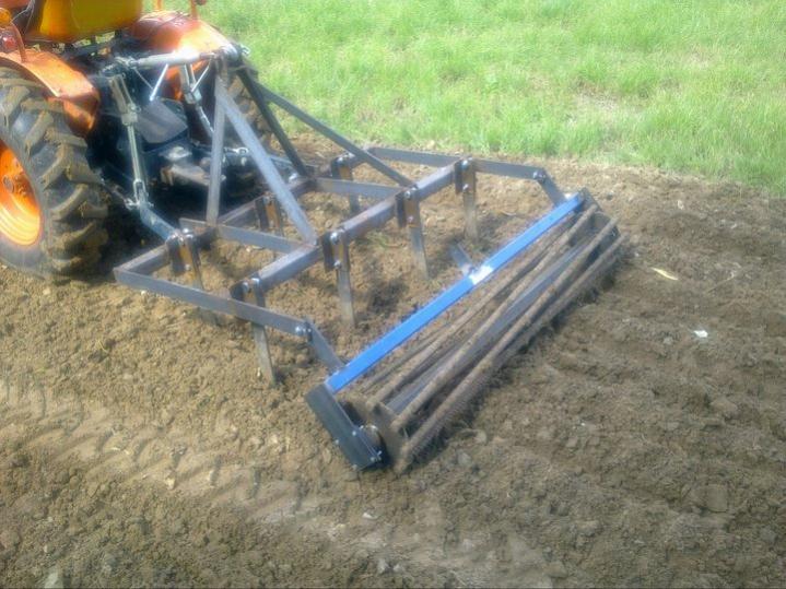

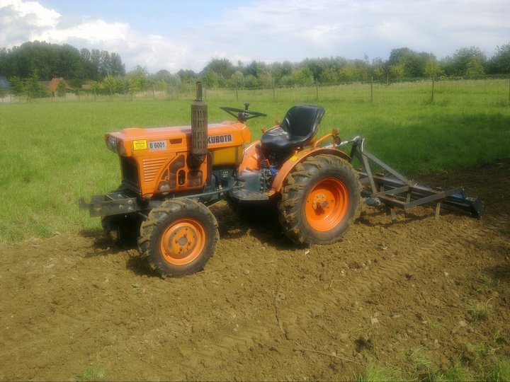

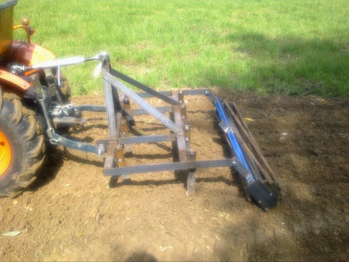

I'd like to share my latest project with you guys.

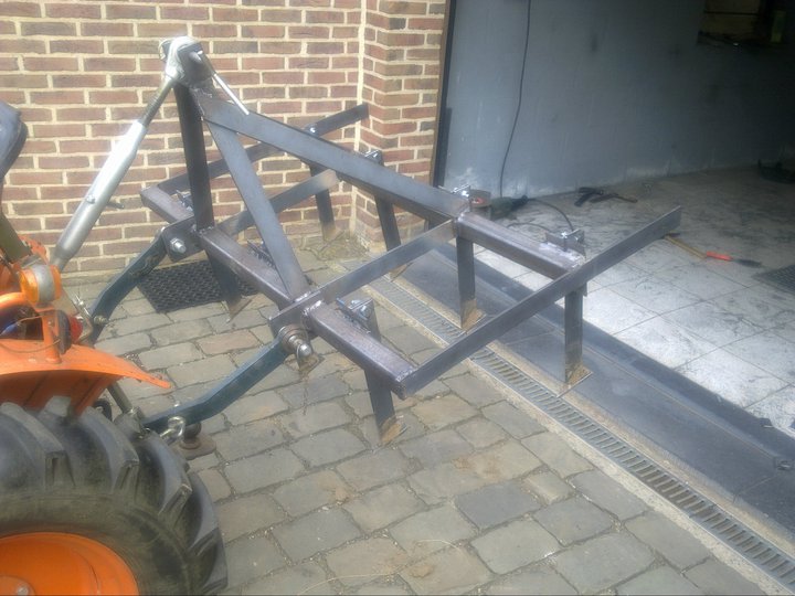

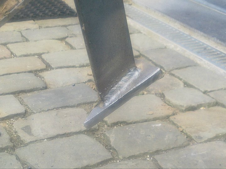

It's a 120 cm (4 ft) cultivator with 7 tines and a crumbler roll (as we call it here). The tines can go up to 30 cm (1 ft) in the ground and the blades are 6 cm (almost 2,5 inches) wide. The crumbler roll has a width of 140 cm (4,5 ft).
I still have to make an adjustment system for the height of the crumbler roll, and I am going to paint it in kubota orange :D.
Here is what it looks like.

It's always a good feeling to build something with your own hand.
Congratulation.
It looks like the crumbler roll if a little bit light...
What do you plant, potatos? :)

No this was just a strip of ground that had to be broken up for seeding grass, but i also plant potatos and vegetables :). This ground is some filling ground which was very sticky, but on our normal Belgian loam the crumbler roll works good :)
