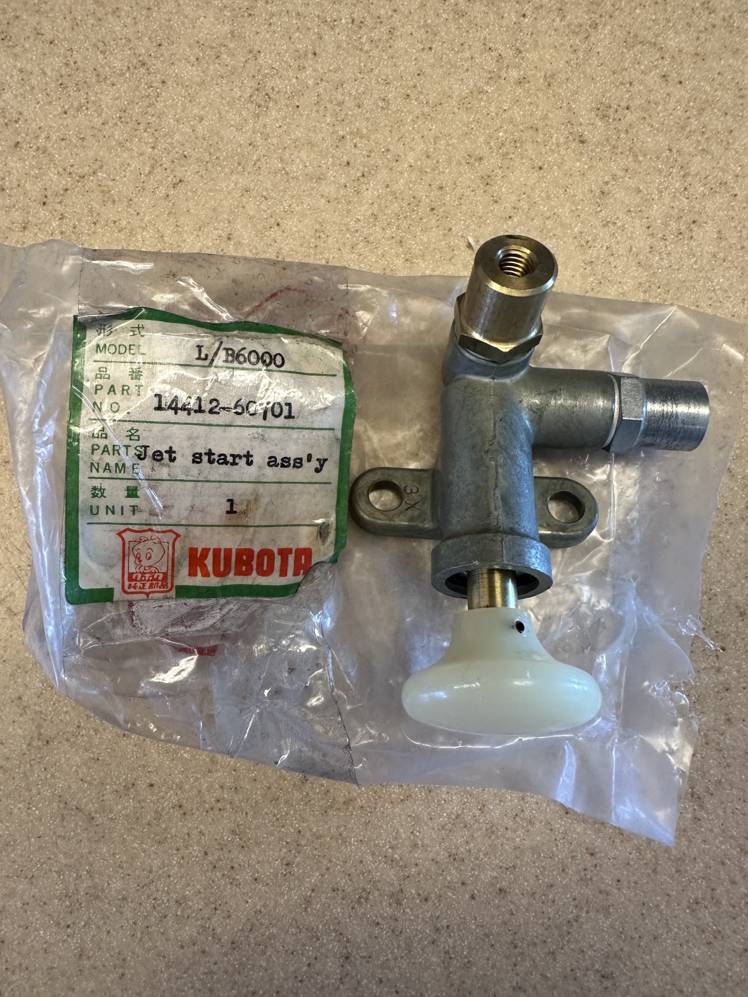

Curious if anyone has any information on how/where to install the P/N 14412-60701 jet start assembly on a B6000? I have had no luck finding any information so far and would greatly appreciate any assistance. Thanks

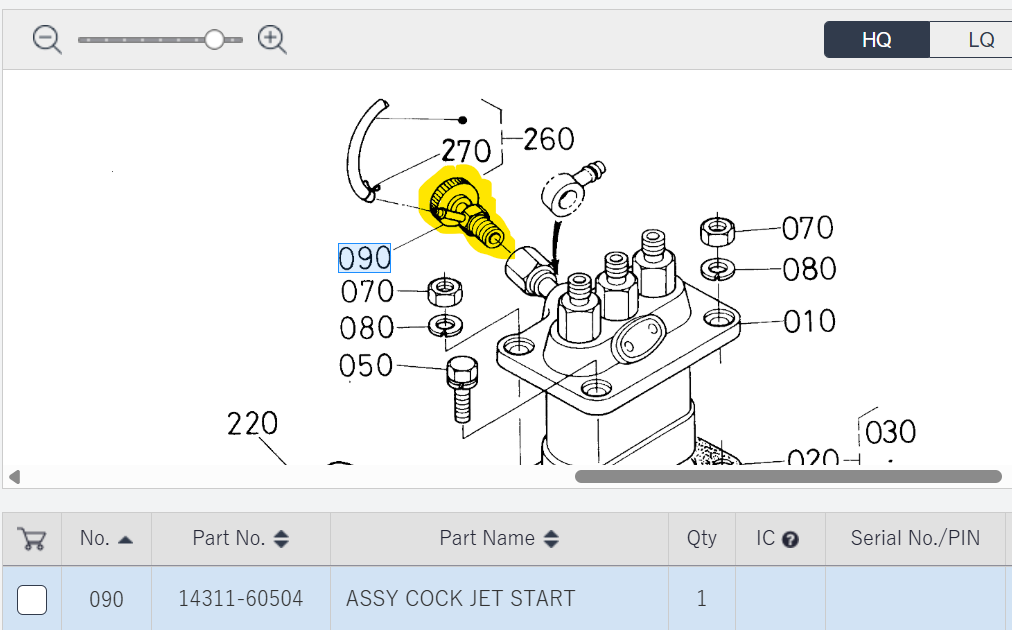

This is a jet start valve:
Take the plug out and replace it with the valve:
Then route the vent to an added tee on the returns from the injectors.

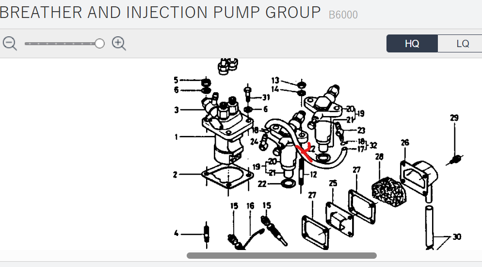

Ok after quite a bit of digging.
It looks like that was an add on option for an extended run fuel tank add on.
Leave it sit on the shelf! ;)
