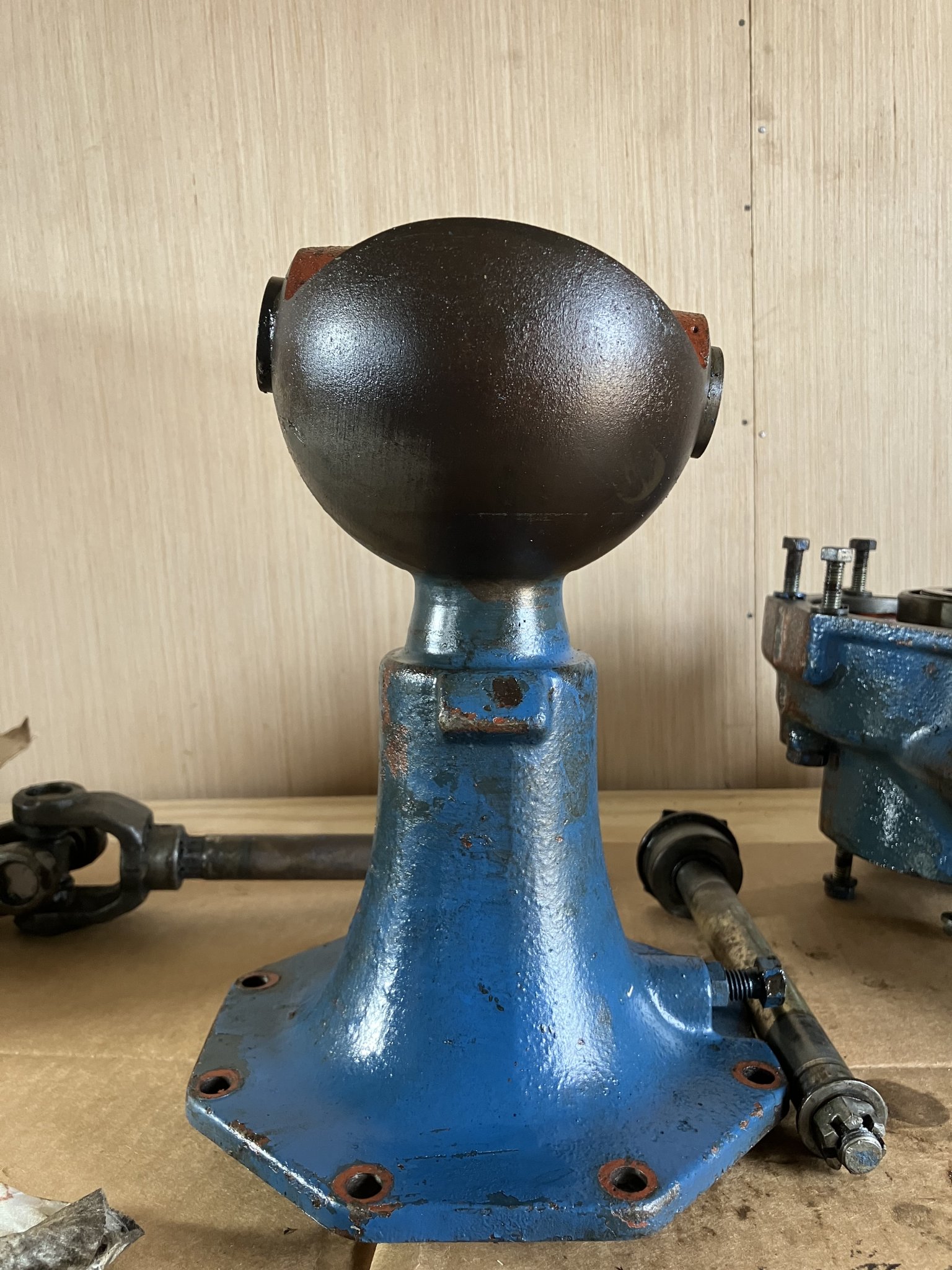

I am gearing to up rebuild the front axle on my B6000 but I have a few questions. First is I’m wondering if anyone knows whether or not the knuckle ball ends on the axle housing should be painted or left raw metal?

I have always left them raw metal, but one thing I would recommend- if the seals for that ball end include a felt seal, replace it with new, and saturate it with oil before installation.
I use 85-140w gear oil.
If you don't, the felt will collect & trap water and cause rust to form.
(speaking from lots of experience with various off road axles & one B7100 axle)
