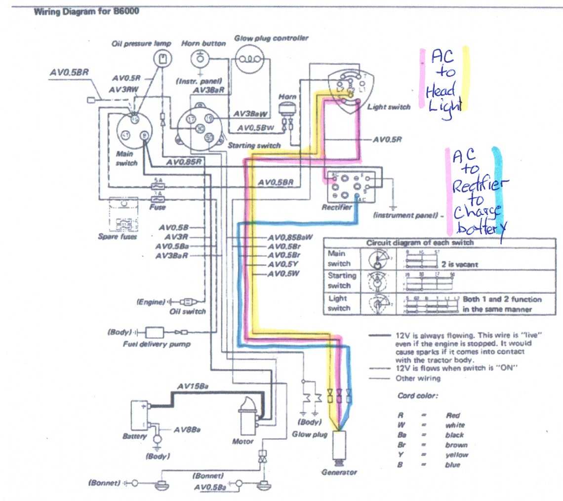

- the wiring diagram is attached. As mentioned previously, mine is wired different than the diagram.
- the brown wire from the Dynamo is hooked to one of the AC terminals on the rectifier
- the other AC terminal on the rectifier is hooked to the battery
- there are no other connections to the rectifier
- there is no continuity between any of the connections on the rectifier regardless of the polarity.
- I suspect this means the rectifier is no good.
I will confess that I still don't understand rectifiers, but based on what I know, I suspect the charging system probably never worked wired in this fashion.

I have marked up the 3 wire B6000 wiring diagram in two formats. JPEG and pdf. The pdf is attached and the JPEG is immediately visible. Depending upon your computer and printer one format may print more clearly than the other.
In the box showing the circuit diagram of the Main Switch, the Starting Switch and the Light Switch the light switch box says both positions 1 & 2 are the same. One position is not brighter than the other.
The dynamo is putting out 3 phase AC voltage. One pair of these phases is used to charge the battery thru the rectifier. These are colored Purple and blue,
Another pair is putting out AC to the headlight. These are colored Yellow and Purple,
If you try replacing your existing headlights with LED's most LED's wont work on AC. A few owners have reported success with LED's but I have not seen this myself but these products are always evolving.
The headlights are not high and low beam. The headlight brightness will increase with higher engine rpm.
Dave

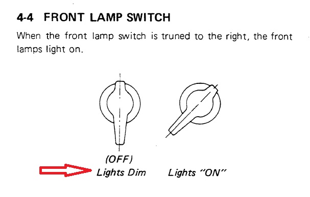

I found an Operators' manual for the B6000 on Kubotabooks.com. It has a much more legible wiring diagram than the same diagram in the WSM.
In the Operators' manual is a description of the light switch operation. Maybe this DIM position is why you think there is two positions when in reality DIM and OFF might be the same.
Does your manual have a clear wiring diagram like this one attached?
