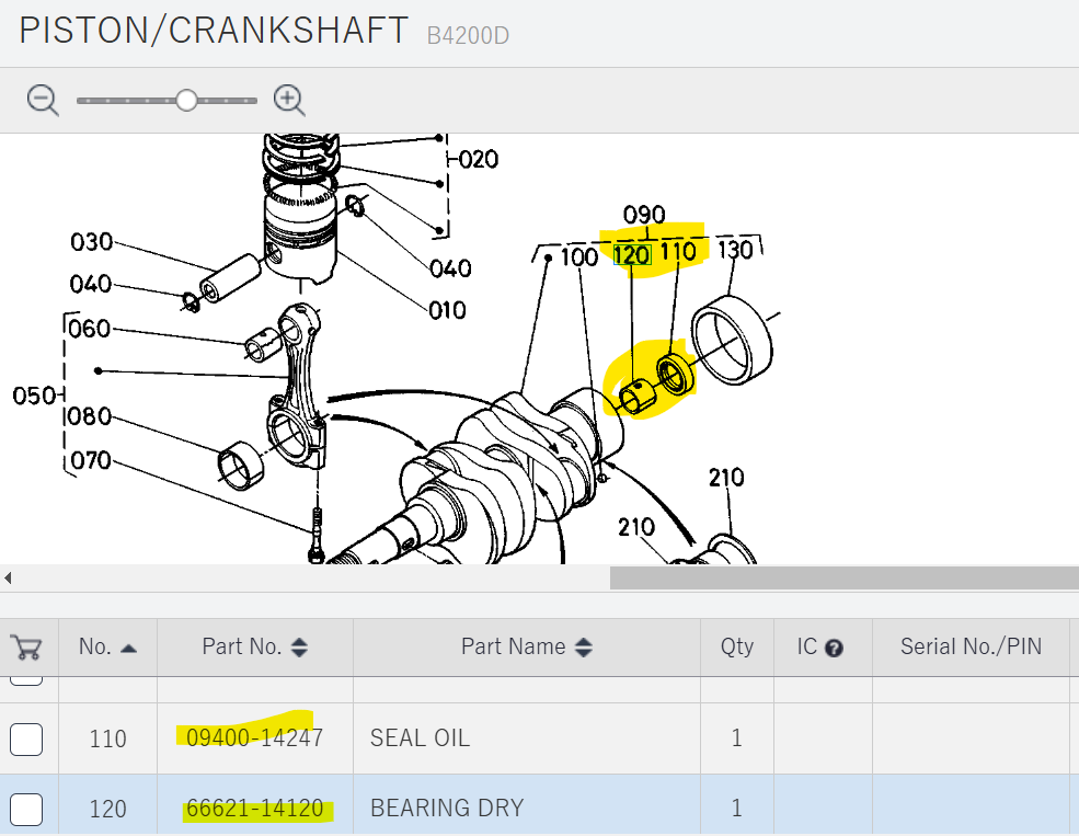

Throwout bearing pressureplate, clutch disk, and pilot bearing.
There might or might not be a seal behind the pilot bushing.
In the print below they call it an oil seal, it's really a dust seal, it is not imperative you put a new on in it.
Unless there is oil in the bellhousing I would touch the engine rear main seal.
The main seal is complicated and mutiple pieces.

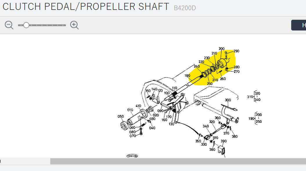

Check this joint for excessive wear.
