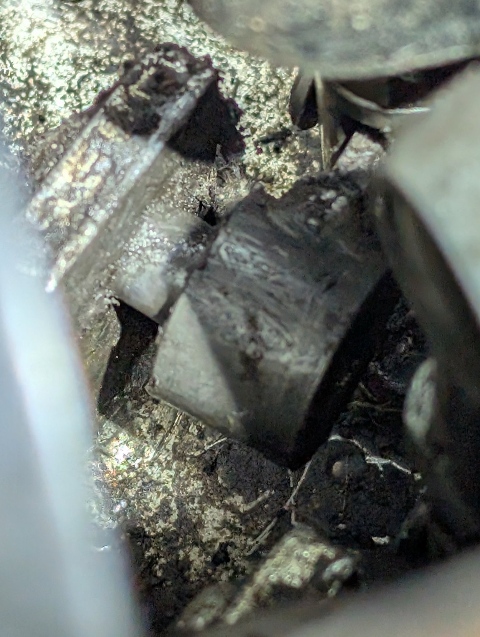

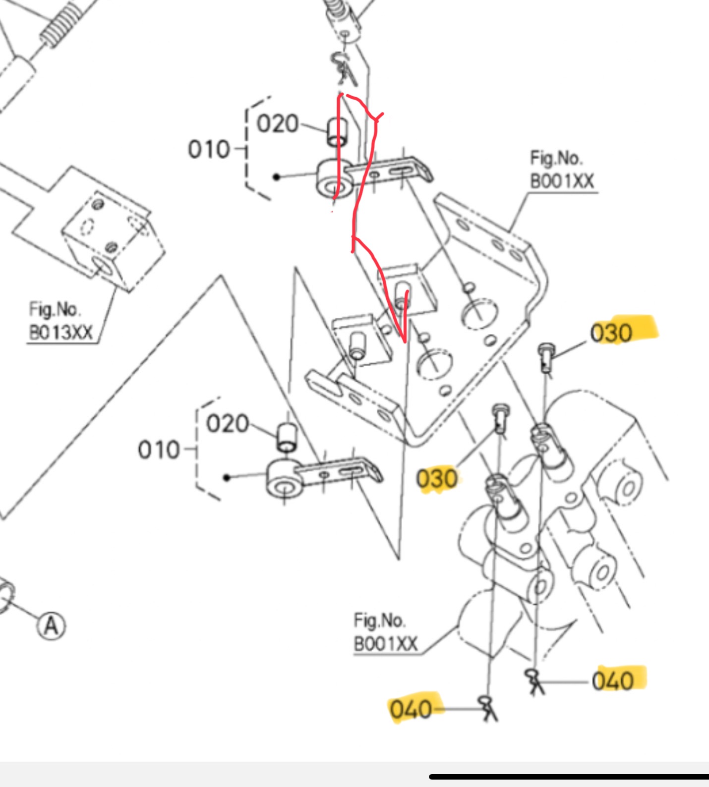

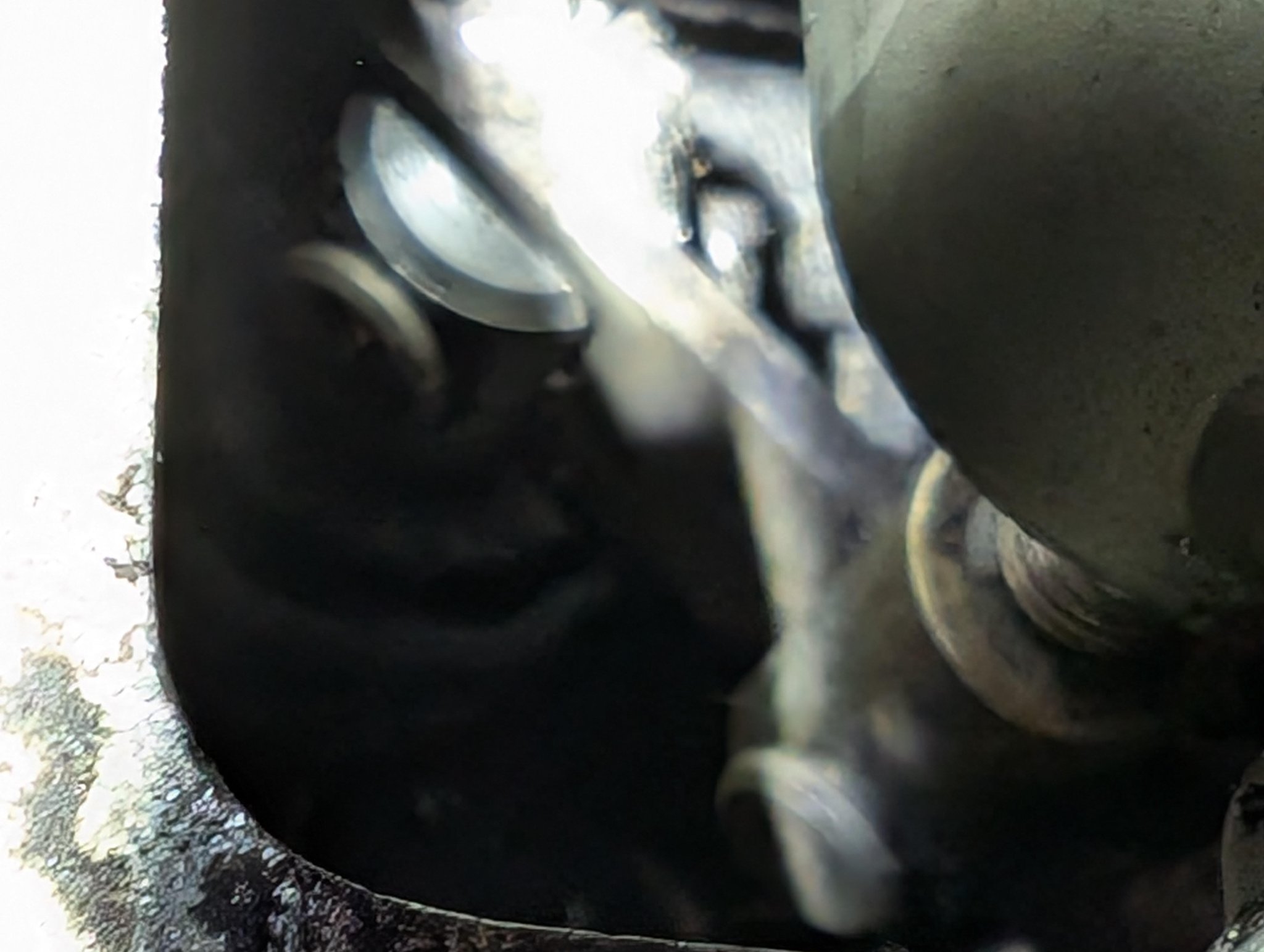

What's happening is that when the Loader lever is moved, the flat rod attached to the valve that has a ring on the end (which the rod in question attaches to) will gradually slide off the pin mounted to the bottom of the box. For some reason that flat rod has lots of sideways play which is allowing is to come off the pin. Could the groove that the flat rod sits in have gotten worn so that it's too wide?

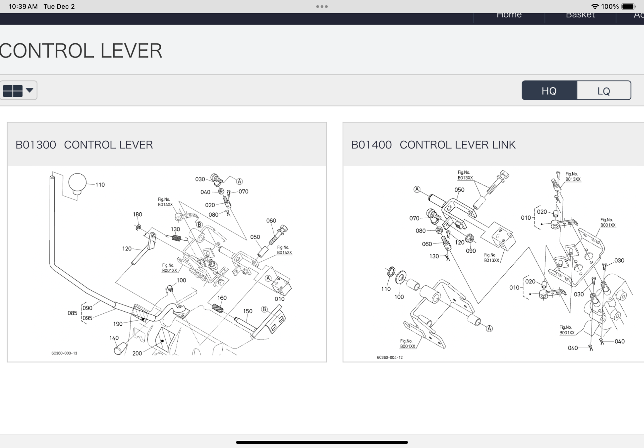

The first pic shows the flat rod where the ring end is about to come off the pin. The second pic shows the other end of the flat rod where it attaches to the valve and sits in the groove. I've tried wedging a small stick in that groove (pic2)to remove some of the slack and it helps but eventually the stick comes out from the movement. I'm not scared to replace parts and have had it apart and together 3 times now trying different things (shortening and lengthening the rod (part #030 from the diagrams of previous post), but I'm not sure what to replace.... Any and all ideas appreciated! Stay Warm!
