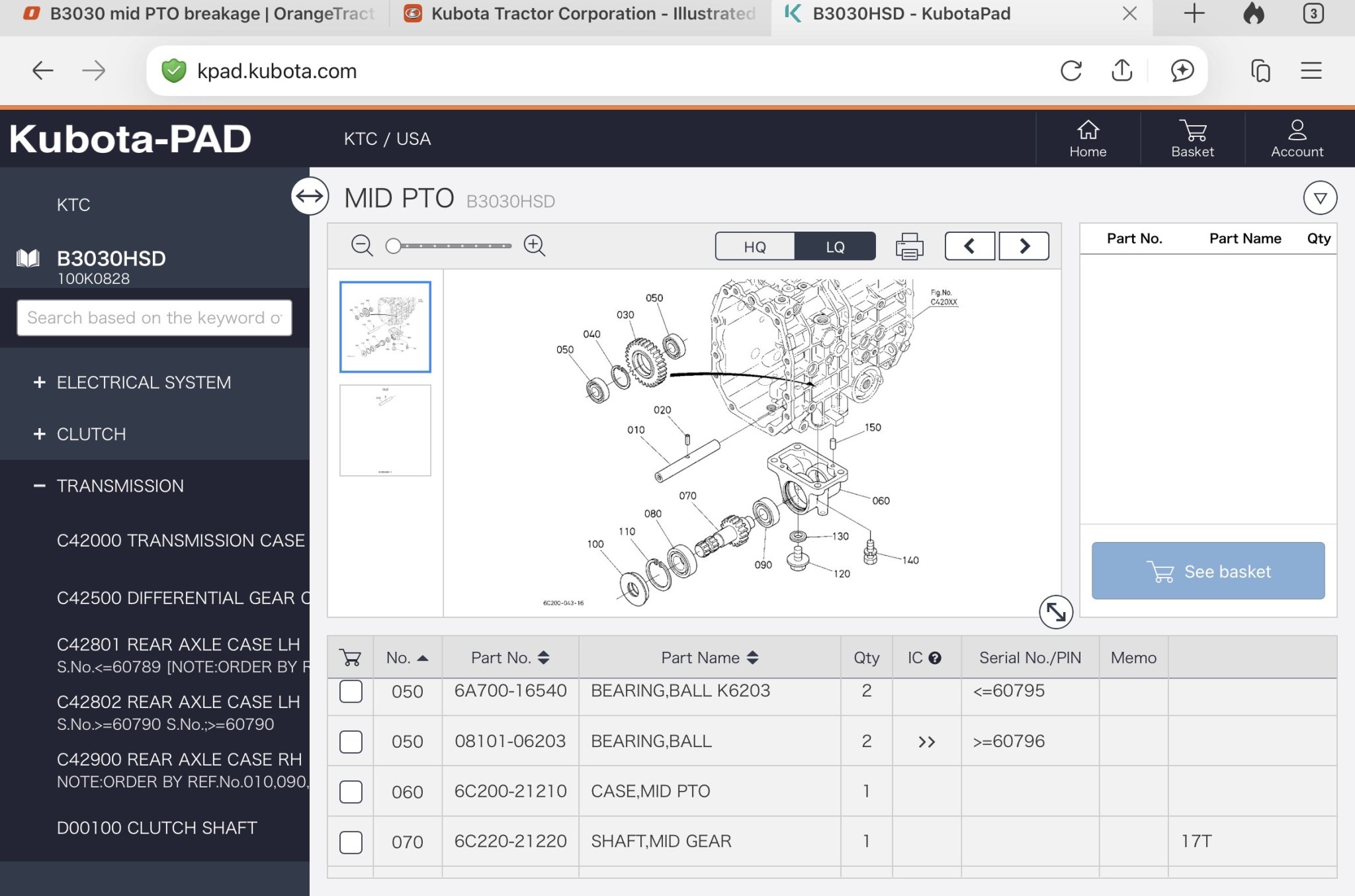

Until today, she calls and said 'the shaft came out again, but it's leaking fluid'. Well from the pictures, her new shaft is fine, but the housing and two bearings holding the output shaft for the mid-pto broke off and fell down. I'm about to take a trip and haven't looked at it myself yet. Is the mid-pto on these tractors a bolted up affair to the main transmission hopefully? Or is this a piece of the transmission housing that means the whole transmission will have to come out and be replaced? From the pictures she sent me, the stub shaft that the pto drive shaft goes onto is now on the ground. It has a gear and two bearings + the broken piece of housing.
