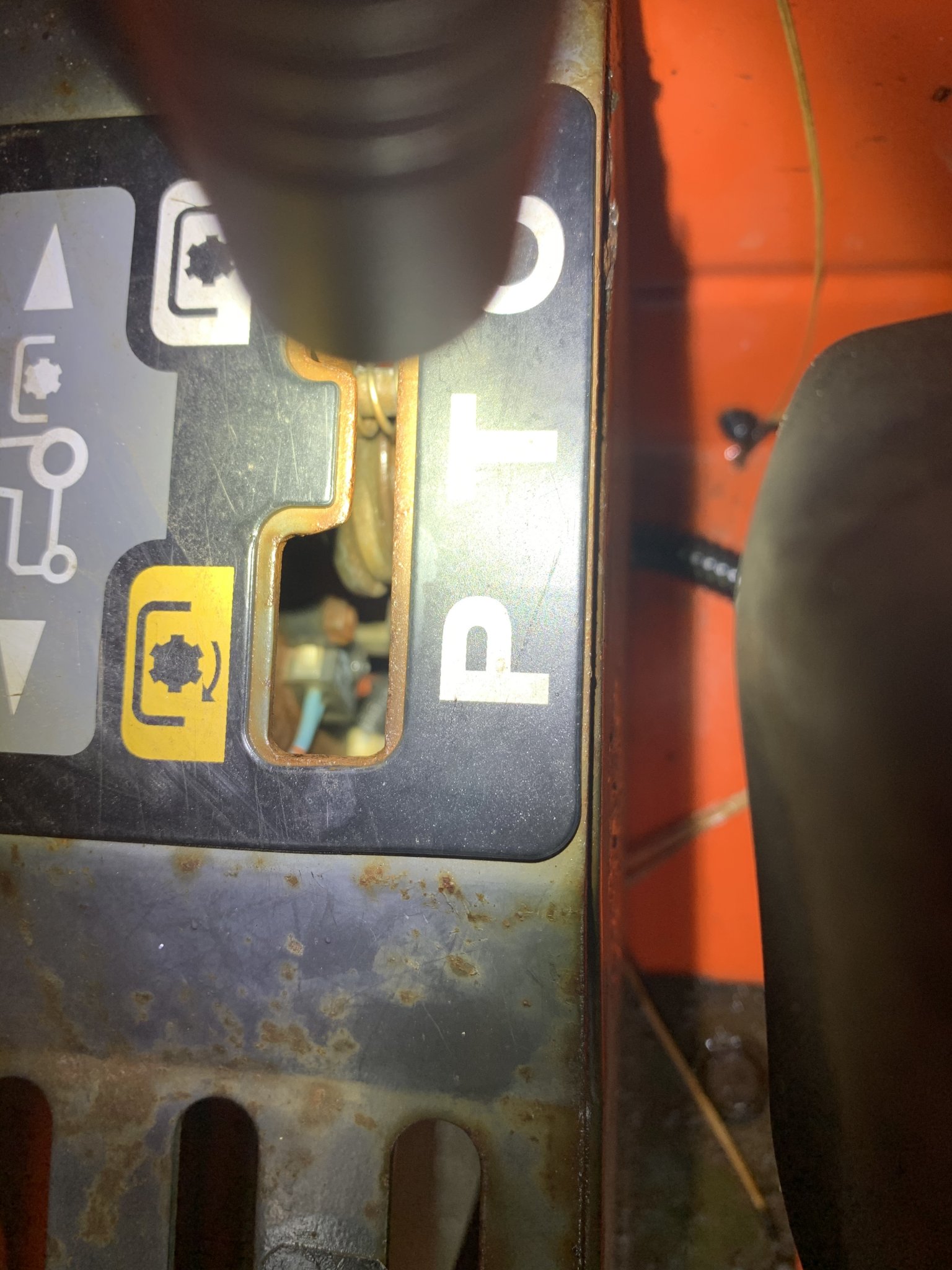

10 is PTO
20 is HST
60 is seat
No idea what 50 is.
And I'm not sure of your tractor, but there could be a switch on or near the actual PTO lever. This is an L5030, may be the same.
