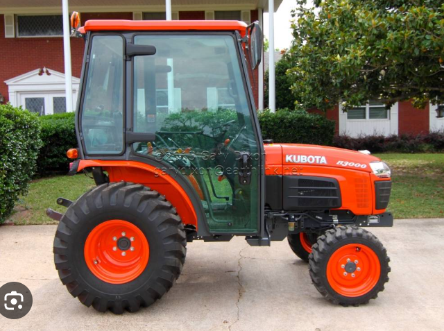

This is a B3000
I don't think that's the tractor your working on.
