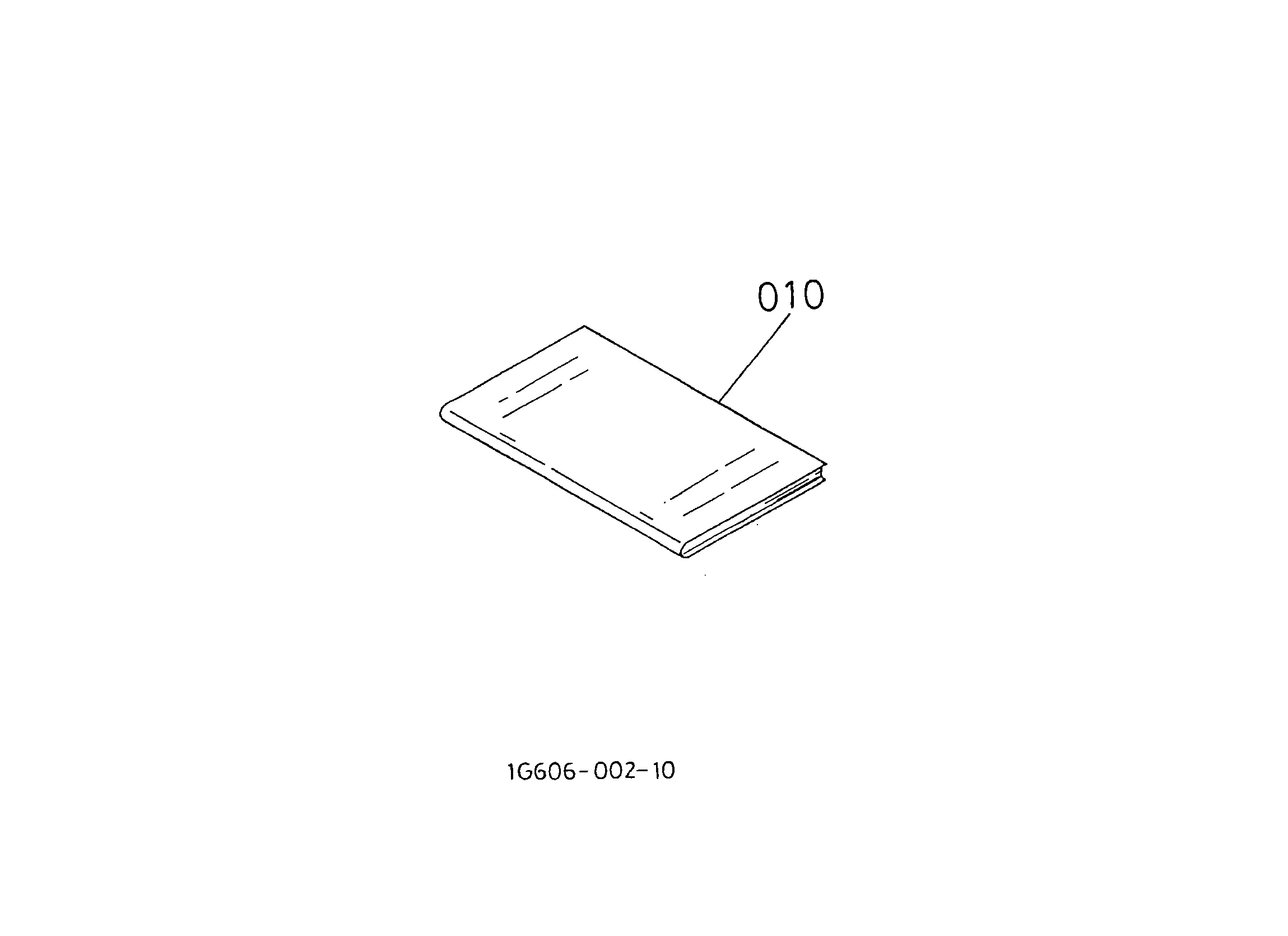

The lift rod that goes from the 3 point hitch to the mower has a turn buckle in the middle. It’s a long nut with a jam nut, numbers 60 and 70 in the attached diagram. Adjust that so the rod is lifting a little bit more taking tension off the adjusting knob.
