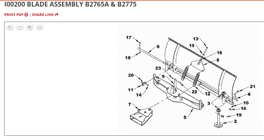

I already have a DIY quick attach setup on my loader frame. I use it to switch between my loader bucket and pallet forks. I just want to retrofit my existing Kubota frame mount snow blade and adapt it to a quick mount plate.

I might add that my main objective here is not have to remove the loader frame and to be able to retro my blade to a quick connect. Just looking for ideas

Seems reasonable but without some pics of the blade or a model number hard to speak to specifics. Kubota parts isn't finding B2765A. Is that the whole goods kit number?

Should have asked Google to start with. Messicks has the parts diagram and looks very straight forward to me. Get a blank SSQA adapter plate and either:
  1. Weld the mount (#7) to it
  2. Or fabricate/weld a clone for the male side of the Kubota quick attach to it.
I like #2 - does not modify the OEM mount on the blade

Yes pretty much what I was thinking. I'm just wondering what having the blade assembly so far out on the ends of the loader arms will do as far as bouncing or possibly torquing the loader arms and bending them. I will definitely fab this so if it doesn't work out I can go back to the original configuration so I might just fab the #7 adapter and keep the original in good shape . Problem is the frame mount plow works so well and is so compact but a PITA to have to remove the loader arms all the time we get a snow forecast
Its a standard setup and actually less extended than most.

Take part #7 off and then weld a tab to each end of part #5. The tab will be large enough to accommodate a 5/8" hole drilled into it and will face rearward. Then weld 2 matching tabs into the loader bucket on each side. Put a pin through each of the welded tabs and through the tabs that are welded to the plow frame. Your plow is not securely attached to the bucket, and you can use a chain from the plow to the center of the bucket, so the plow will have its own weight to keep it in contact with the ground. This is how I did it 20+ years ago. I Bought an old Fisher plow and welded the tabs to the bucket. Worked great and you could pile snow as high as your bucket would go.
You will like the SSQA plate attachment way better than hanging it off the bucket. The bucket idea puts the blade even further forward with a longer lever arm pushing sideways on the front of the tractor. I have tried both and the SSQA attachment is way more effective.
