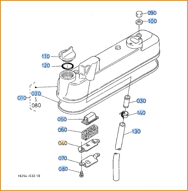

What comes out of the breather pipe (item 130) when the engine is at speed and under load? Smoky vapor and oil mist? I suppose a guy could fashion some sort of catch can and see what shows up after 10 hours use...

I just discovered that the oil is coming out of the top of the head cover where the bolts and washers. Especially the front two and a little on the third one from the front. I tighten the bolts some and the oil still come out so I just ordered a set of 4 new copper washers. They should arrive tomorrow. I’ll replace the washers right after I receive them. I’ll post more later here if that solve the problem.
