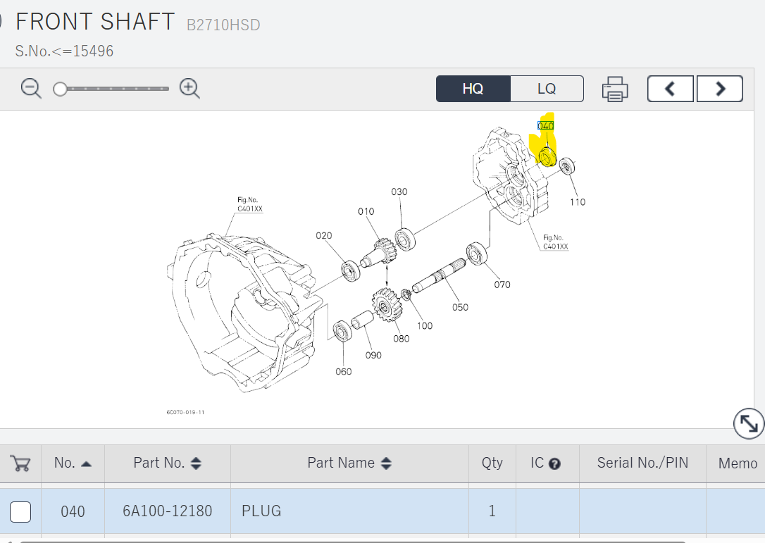

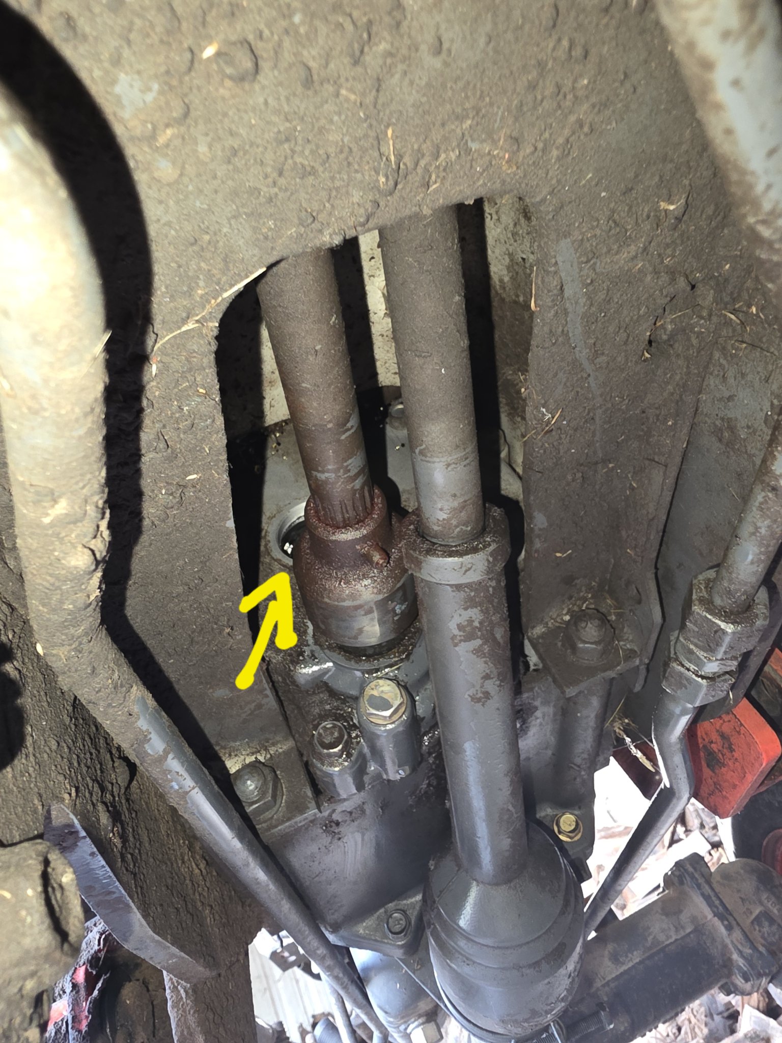

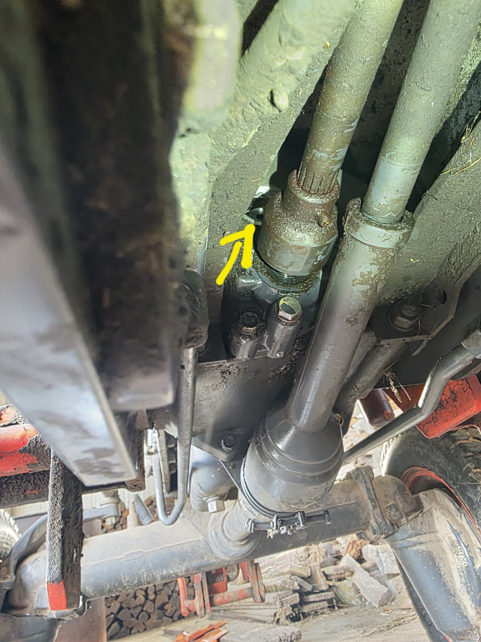

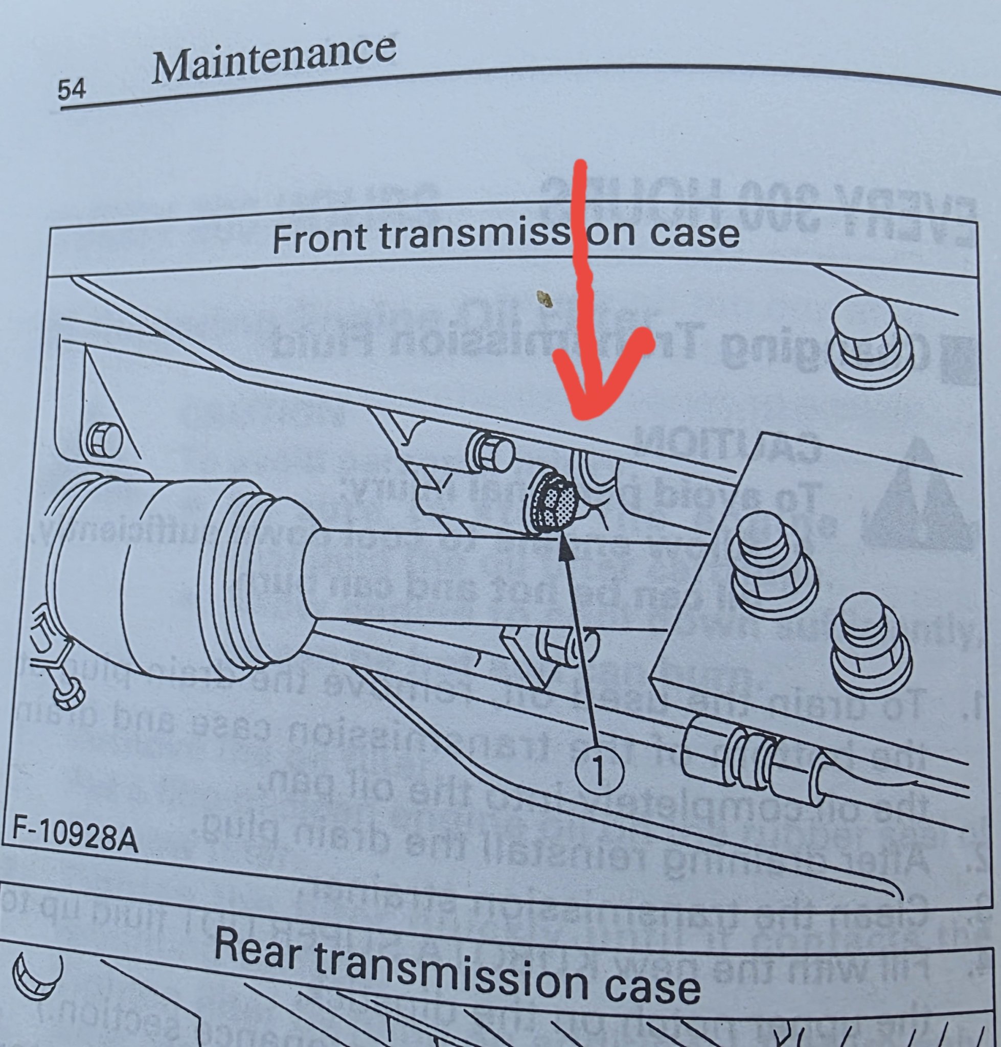

B2710 belonging to a relative leaked hydraulic/transmission fluid. I eventually found that the leak was coming from the shiny rimmed hole I'm pointing towards in the pictures. Owner's manual only shows it in one place and doesn't say what it is. It is a little bit above the front drain for the fluid. Local Kubota dealer doesn't know what part I need, but I think I need some sort of cover. I'm not a very strong mechanical person, but I will do my best to answer any questions.
Thanks.

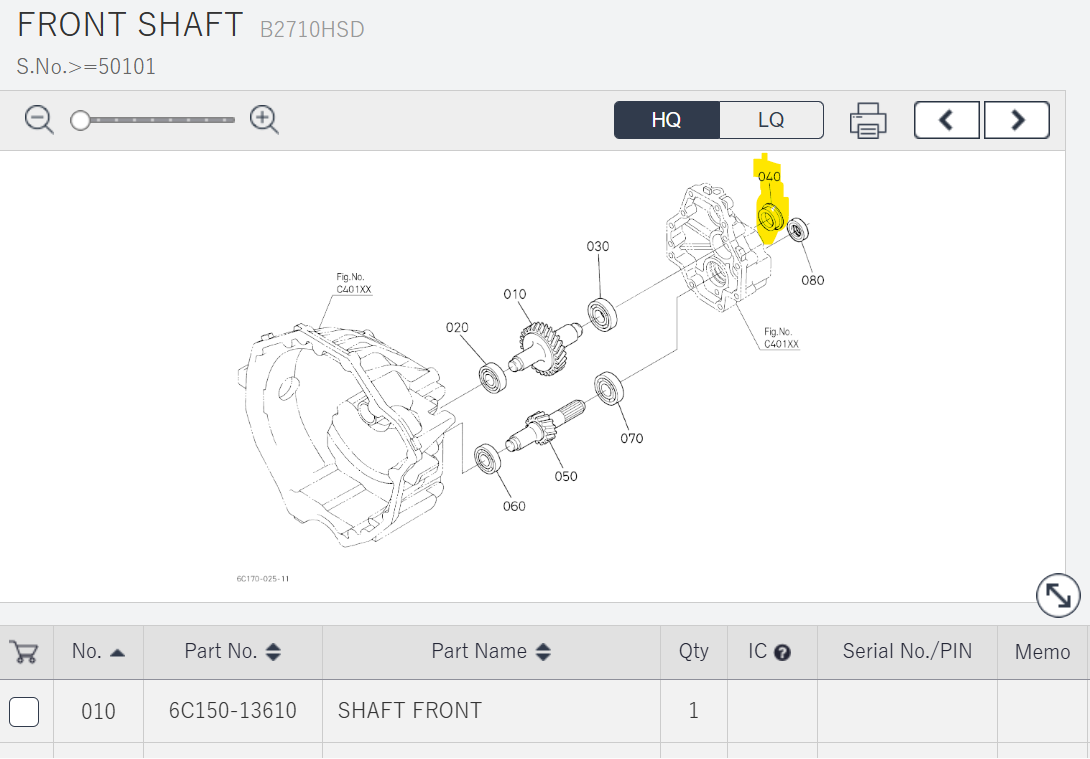

Thanks Mr. Wolf. That makes sense. Can you please give me the serial number of the 030 part as well? We found a broken half circle on the ground and the dealer said that it was part of a bearing assembly. They suggested one on the mower deck, but I don't think that is correct. I'm now thinking that it might be part of that 030 part.
Much appreciated.
