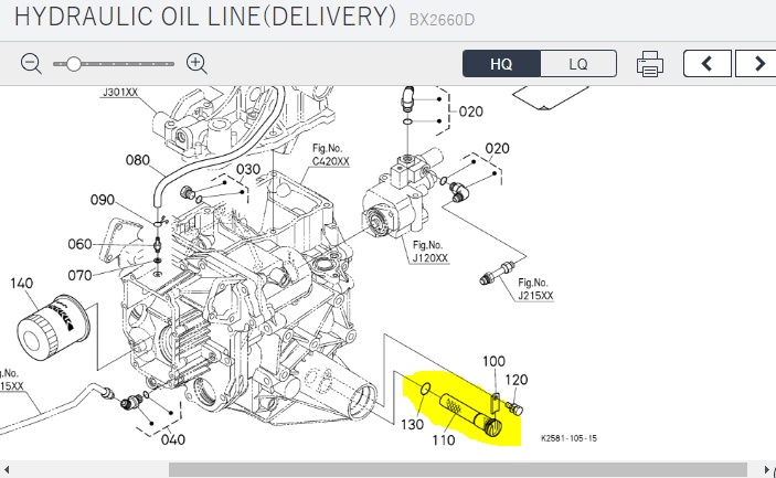

Good day folks
the power steering does not work very well on my B2660 tractor when it first starts
when cold I can turn the steering wheel and it dosent turn the tires very well when it gets a little
hoter it seams to work better?
the filter was changed last year and the fluids are at proper levels
i asked another group and someone mentioned a possible clogged screen filter?
If so where would I find that screen?

Kubota never made a B2660. :unsure:
Is it a BX2660?
And if it is a BX2660, You could have a screen clog issue.
