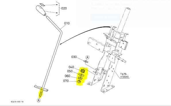

J Jasonc New member Equipment B2650 Mar 4, 2022 4 0 1 NC Mar 29, 2022 #1 My B2650 started having problems maintaining rpms. the throttle lever keeps dropping several 100 rpm. Is this just an adjustment? Appreciate any info. Thanks.

North Idaho Wolfman Moderator Staff member Lifetime Member Equipment L3450DT-GST, Woods FEL, B7100 HSD, FEL, 60" SB, 743 Bobcat with V2203, and more Jun 9, 2013 30,872 6,901 113 Sandpoint, ID Mar 29, 2022 #2 Look under the dash there are 2 nuts on the linkage, loosen the lock nut tighten the inside nut, then lock it down again. Last edited: Mar 30, 2022 Reactions: 2 users

J Jasonc New member Equipment B2650 Mar 4, 2022 4 0 1 NC Mar 30, 2022 #3 North Idaho Wolfman said: Look under the dash there are 2 nuts on the linkage, loosen the lock nut tighten the inside nut, then lock it down again. View attachment 77425 Click to expand... I'll do that. Much appreciated.
