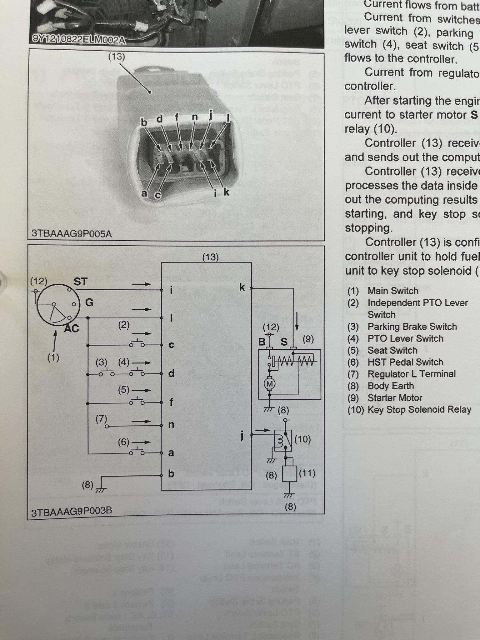

Follow the WSM to figure out what's going on, because the most common is the Seat switch, bit it could be mutiple other things causing it too.

I’d check the circuit out at the OPC controller. If the circuit checks out good then replace the OPC controller. A bad controller will act exactly like a bad safety switch.
11,380
4,891
Before you replace the $320
OPC, CONFIRM it's getting the 'seat switch' signal first !
Follow the wiring diagram in the WSM Electrical section , you might have an open wire.
Since you bypassed the seat switch, it's not the switch ,sounds like a wire's been cut.#030 is the 'controller' that's $320 !! I'd hate for you to shell out $320 to replace a good OPC and when installing the new one see the cut wire that IS the problem.

The reason I mentioned doing the circuit testing at the OPC connection is because the OPC is the command center. If you take a voltage reading, battery on, and you don’t have a signal up to the OPC while you’re in the seat then it’s a wiring, fuse or switch issue. Right now your OPC is either getting bad data, no seat signal, or it’s getting good seat data up to the OPC but for some reason the OPC no longer acknowledges that signal. Every time you step on the pedal or engage the PTO the OPC doesn’t have any signal from the seat switch and commands the engine to stop.
