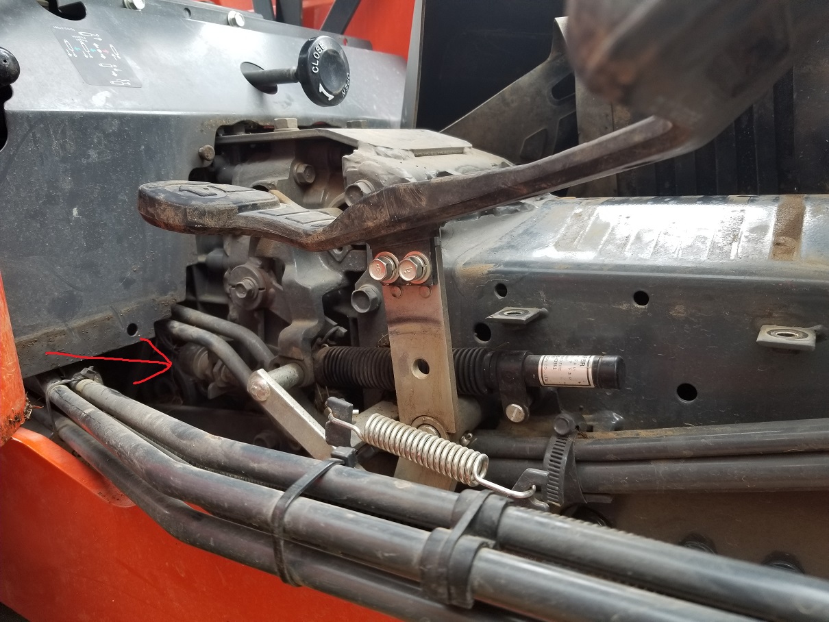

#Rkidd - thx for the info...just to confirm, you are talking about the "safety switch" right?
Hopefully I just attached a picture of it....
Located on the forward/reverse pedal side up and to the left from under the machine.

Yup, neutral safety switch. If you have a cabbed tractor, the hatch under the rubber mat right in front of the seat will give you access.

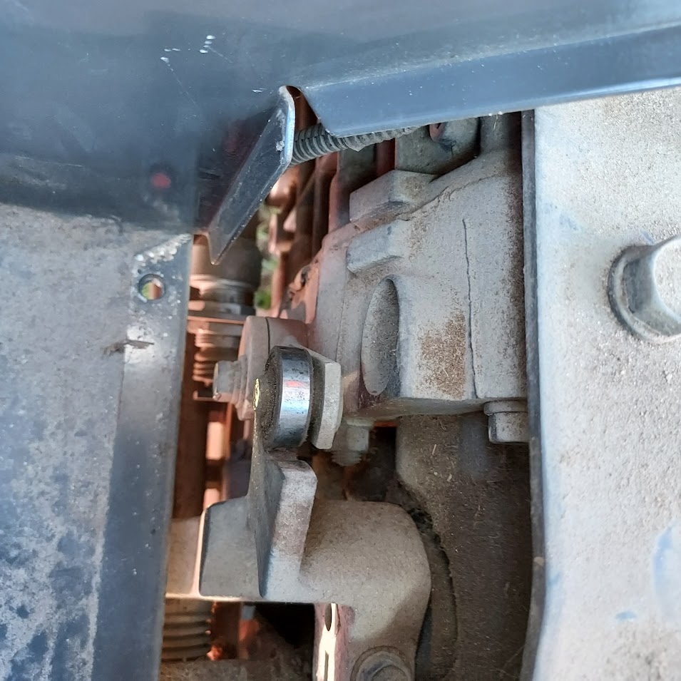

First time tractor owner. I used this thread over the last few days to diagnose and find my problem with my B2650. Thank you very, very much! I have the HST switch, but I can't get my hand in the spot to remove and replace. Do I need to take the wheel off? How to I actually remove the switch (for example, do I pinch together the plastic part)? I have a cab model if that matters. Here is a photo of how cramped the space is, but I can get to it with one hand underneath.
3,261
4,104
