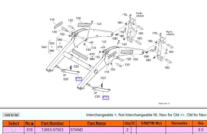

Is there a place I can order the FEL stand legs for my B2650 online to replace my current ones. First time trying to disconnect the FEL and I guess I didn't have the bucket curled down enough, wound up making contact with the legs first and it didn't take much to bend them pretty badly. I bent them back but not sure if they're compromised now, might be better to just replace them.

I went to messicks and it doesn't look like they have a parts diagram for the loader. I'd just give them a call.

Oh nice, didn't know you could order direct!
I think he means go to Kubota for the diagrams. I know they have the details Messicks does not.
Order from Messicks, or your local dealer, with the info from Kubota.
