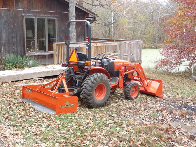

What size of box blade can it handle?
I'm running a 60" with no problems. However, I think a 72" would be too big.
I will say that in wet ground I'm maxing out with a 60 inch. I avoid wet ground/gravel and wait for everything to be moist instead. A little drainage makes a huge difference.
