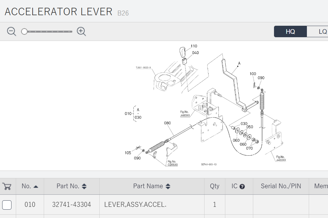

Lets clarify something, when you say "give it gas" are you talking about stepping on the HST pedal, or are we talking about the throttle lever on the right side? (bottom pic)
If it's the HST pedal Sounds like you have either a seat switch issue or an HST switch issue.
If it's the throttle lever on the right side won't raise the Engine RPM's then you have a fuel issue.
