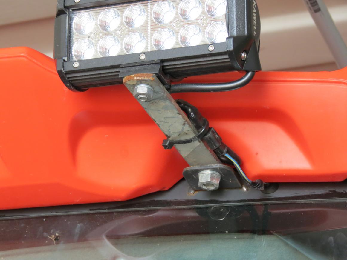

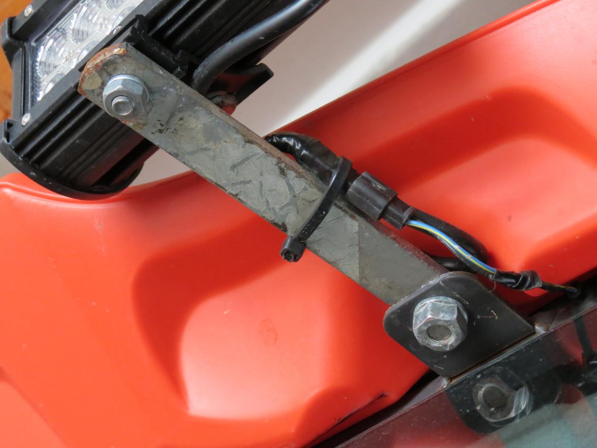

They don't fit the oem mounts but just go to a hardware store and pick up a piece of 1" flat stock to extend the lights out so they don't hit the roof and solder the oem wire connectors to your new lights, very easy and quick to do. I'll post a pic of mine after a bit.

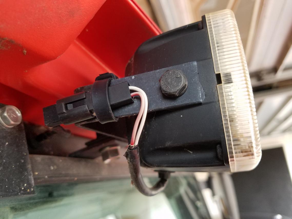

Here is what I did.
Work in progress, so the wires are still long. This is basically how the finished wiring will look though.
