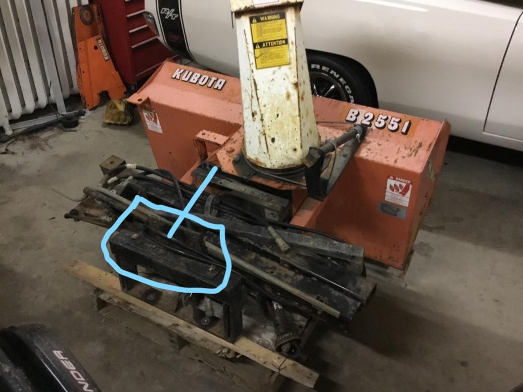

Hey all. I am looking for the bracket that attaches the blower frame on a B2551 to the frame of a B6200. That is the missing link between hooking the blower up and throwing some snow. Does anyone know if this bracket is available to purchase anywhere or have the dimensions for the bracket? Thanks for any help you all may have.

On mine it is a simple piece of angleiron. Mine is on a BX24 but it originally was on a B6200 then on a Bolens tractor and now adapted to the BX. looks like it would be easy enough to fab up?

Fabbing up is the plan right now, I just didn't know how critical the height of the bracket would be. I was curious how critical that height of that bracket would be in terms of how far down the blower would go. A shorter bracket would hold the blower higher off the ground while a longer bracket would make it closer to the ground. I imagine you can tilt the blower down or up more to make up any difference in the height of the bracket. Thanks for the idea with the angle iron.

My blower is level with the pins in the center holes. I have tried it in the other holes but level seems to work best.
