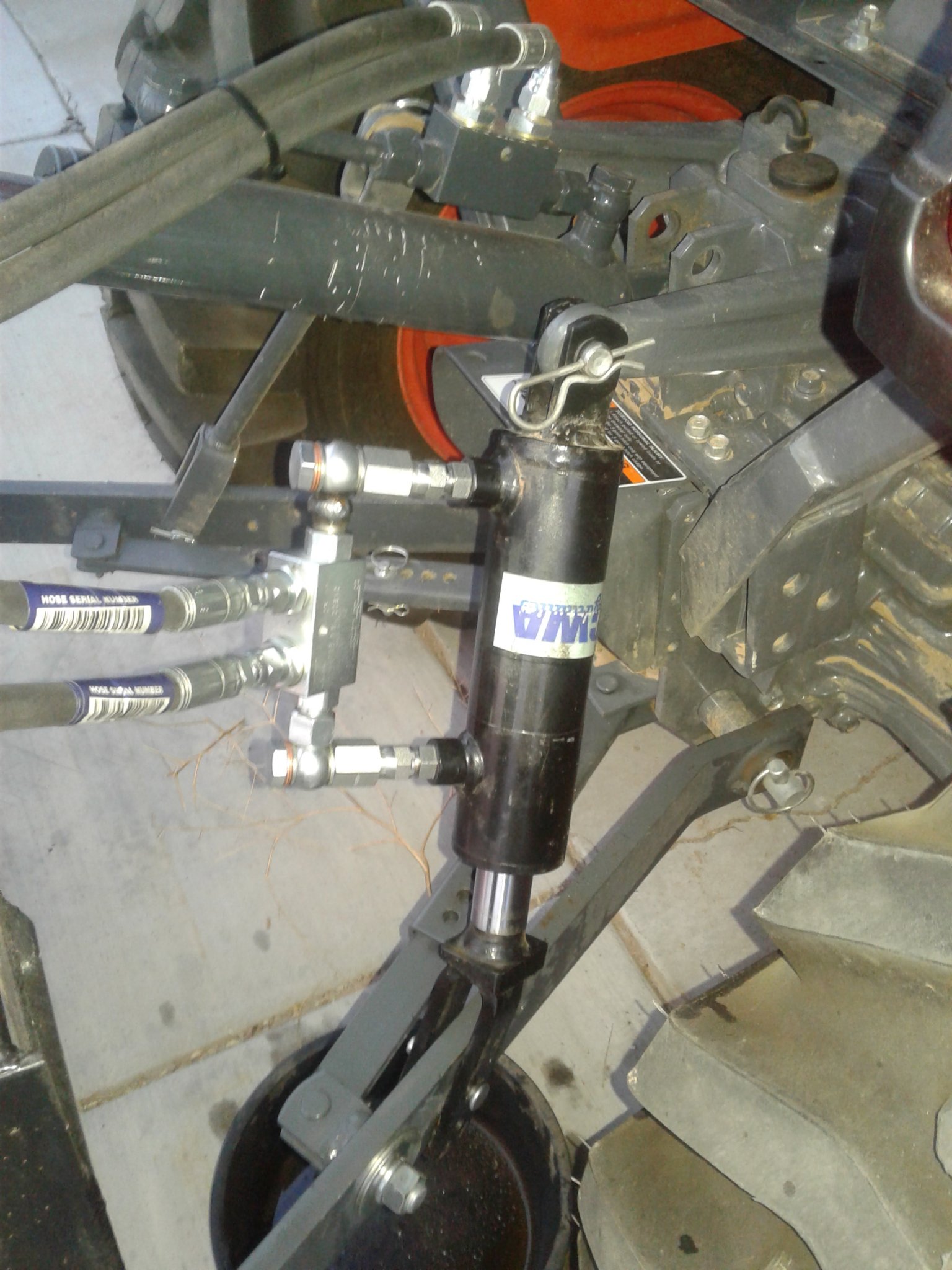

I built my own top and side like plus hyd's for $1300.00 there is also a 3rd. valve for the front w/quick couplers for all. I just haven't ran the new hyd. line up front yet for the grapple. TOP LINK 1.jpg 20200825_060442.jpg
