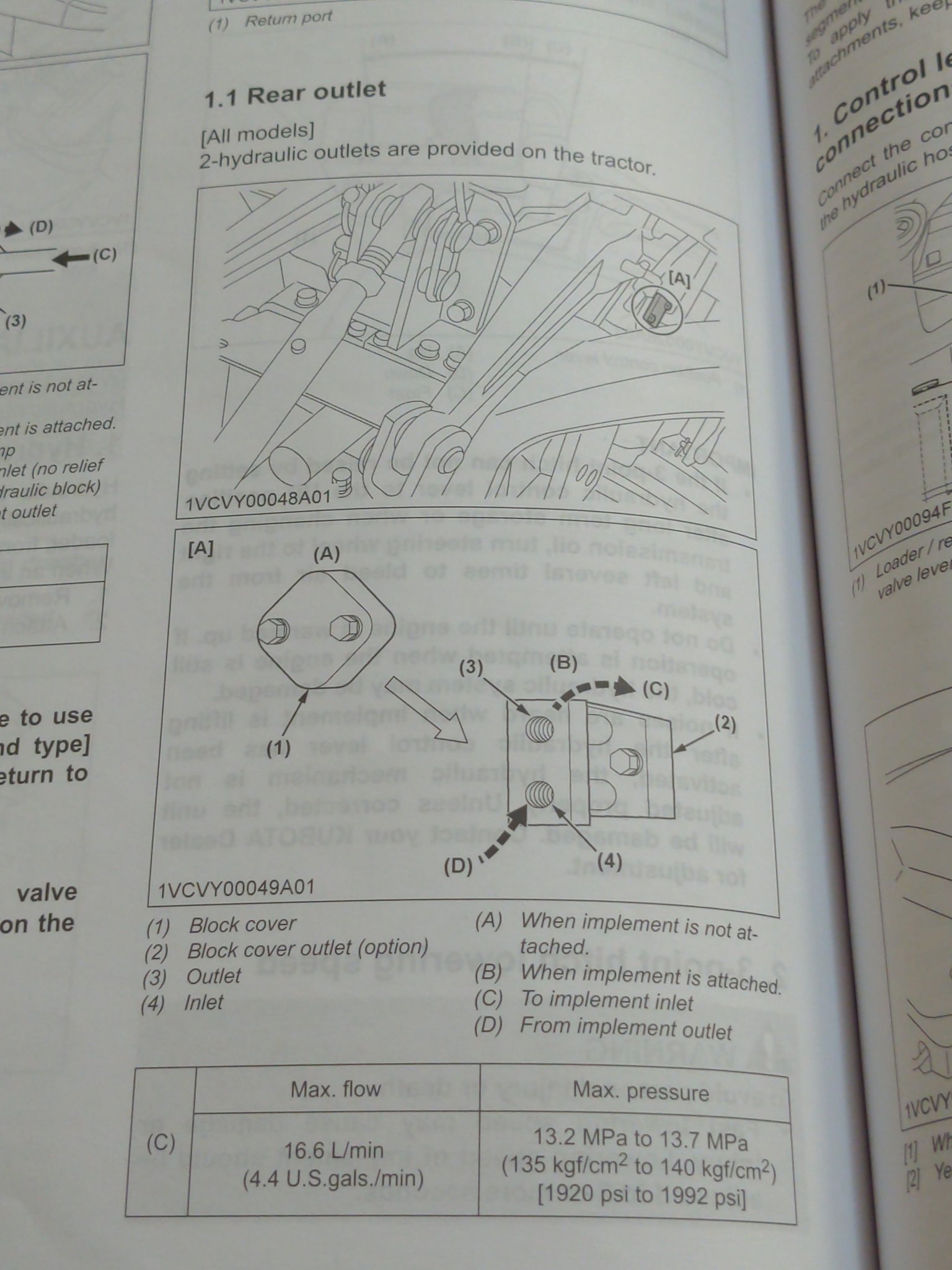

Noobie here. I came across mention of a rear outlet on my 2401 in the ops manual. What do I need to do add rear remotes? Would I be able to use the rear remotes in conjunction with the FEL?
You would need that optional outlet block along with a suitable control valve and plumbing (hoses, outlets, etc).

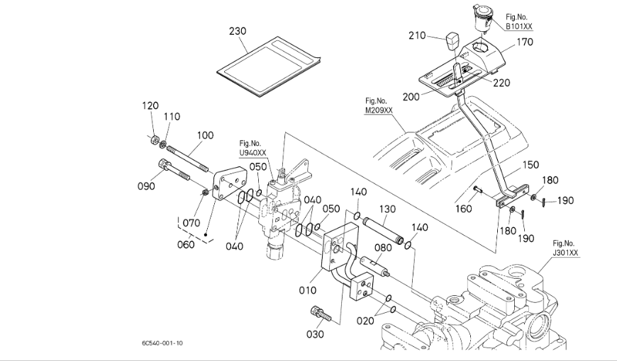

Kubota makes an optional rear remote kit (B1654) for the B2301/B2601 but oddly it is not listed in the B2401 parts catalog. nor can it be configured when building a new tractor. It appears the valves mount on that outlet boss using a special valve adapter - item 10 in the parts diagram below. ISTR discussions of people using that kit on the B2401 but I would have to research that to be sure,.

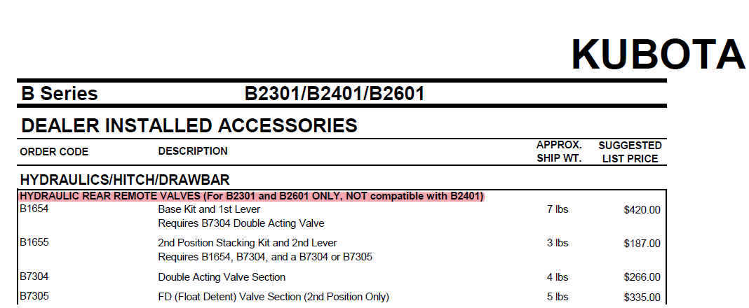

After some research it appears the B1654 OEM remote kits for the B2301/B2601 cannot be used on the B2401. Another red-headed Kubota stepchild,
