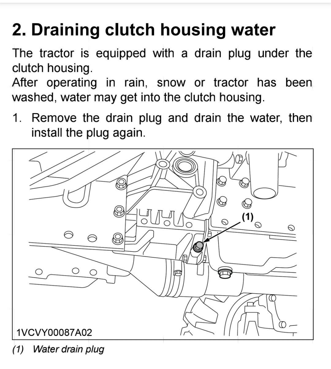

I was browsing the B2401 manual and noticed this "as needed" maintenance item

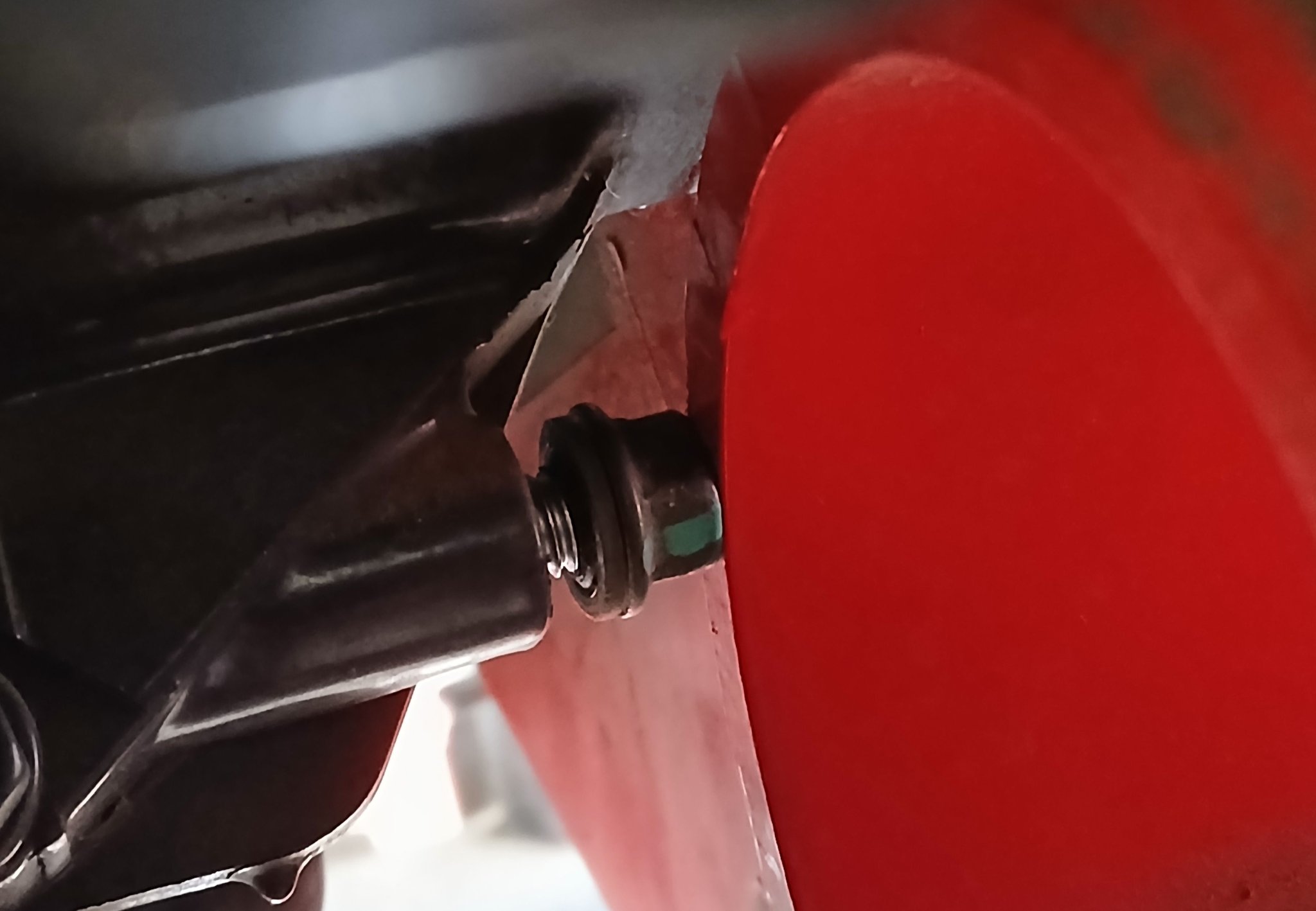

So I crawl under my tractor and find that it is just behind the loader bracket. I was able to loosen it, but was only able to back it out about 3/8" before it hit the loader bracket.
No water dripped out, so am I done? Or do they really expect us to remove the entire loader bracket everytime it rains or we clear the driveway of snow?
