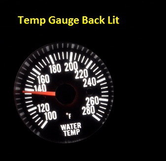

Agree with the above. Considering all you've done to check for reasons....it might well be an inaccurate gauge or sending unit. Shoot the radiator (top and bottom) and the engine with an IR gun.
Add an analog temp gauge so you can monitor coolant temps in real time.
