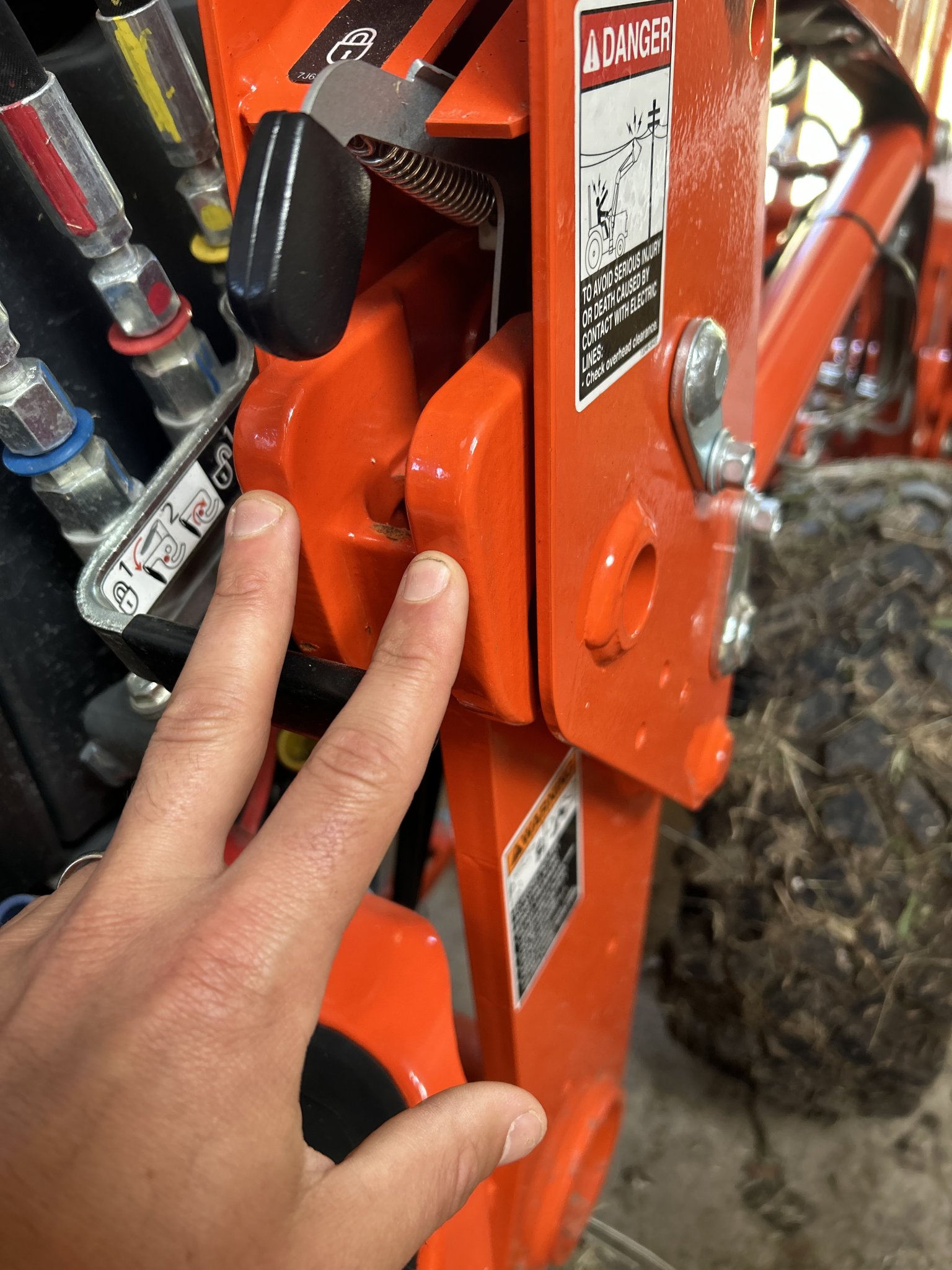

Hey y’all, new here and came over from an old green machine! After using the float feature on my 2301 today for the first time I noticed what I thought to be weird movement at the loader connection points!
In the pic I’m posting I’m noticing the part of the loader I’m pointing to moving back towards me in the seat. It comes back maybe 1/4 an inch when I put down pressure on the bucket? Maybe this is normal, but seemed odd to me.
Thanks

It appears to me that you are pointing at the pivot point for the loader?
I don't have a definite answer, but 1/4 inch seems like a lot of play to me. Does the other side have same/similar play?
How many hours on the machine?
New/used?
Are you the original owner?

I am not familiar with your model or the loader mounting system you have there…but I guess my first question would be is the loader fully seated / docked to the loader frame (mine have pins, so there is no mistaking that…I wonder yours is completely locked into place on the side you notice this? Same on other side?). What keeps it locked in place? Any chance there is a locking lever not fully engaged? Maybe check the manual, undock it and re attach following the manual and see if same result. I am not sure that helps, but that’s where I would start off if you think something misaligned.

it may just be a pivot, but it seems like it moves more than I’ve ever noticed. Didn’t know if after I floated it if something changed? Not real sure what’s happening in that process.
Other side looks like less movement.
30 hours on it, I purchased it brand new.

Ill do that today! You just pull 2 small releases and when you put down pressure the loader walks itself off. No pins, it just sits in pivots. It seems like an odd design from my perspective, just can’t decide if it’s always moved and I never noticed.

OK I went out and looked at mine, yep things move,,, impact wrench on the frame bolts,, *&%*&^*&^% it still moves,,,, SO after a bit of head scratching I figured it out,, the knuckles for the release do infact have a shyt load of play up and down,, so yeah it is in the locking knuckles, so Im not going to worry about it as long as the frame locks in tight Im not going to worry,, its all good

I pulled the loader off and same, all bolts are TIGHT and same movement! Guess it is what it is!

If it helps your peace of mind I've used my FEL extensively (bucket, grapple, forks) frequently at or near max capacity and have had the FEL on and off dozens of times with no issues. After ~100 hrs I don't see any signs of adverse wear or deformation on any of the FEL attachment / clamping points.

Always good to hear stuff like this!!! I mostly move hay with a 3 point spear and brush cut. Of course I haven’t used the FEL a ton, so probably just noticed something that’s always been!
