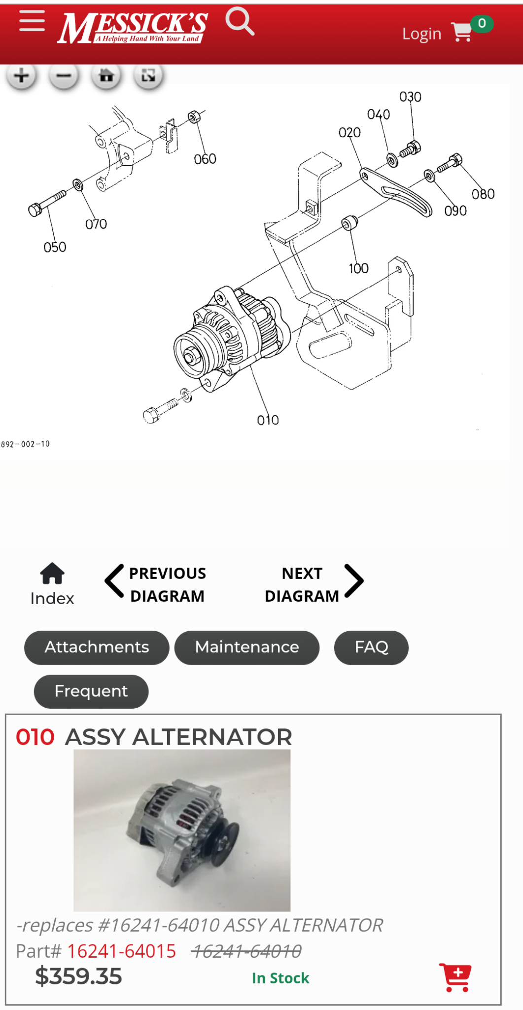

In my notes, these are the Canadian part numbers:
16241-64010
And
New Alternator 100211-1670 100211-4520 16241-64010 16241-64012 16231-24011
I don't know how different the mounting might be for a dynamo vs. alternator, but it's pretty common for terminals to be in different places! As PoTreeBoy says, you may need a different bracket.

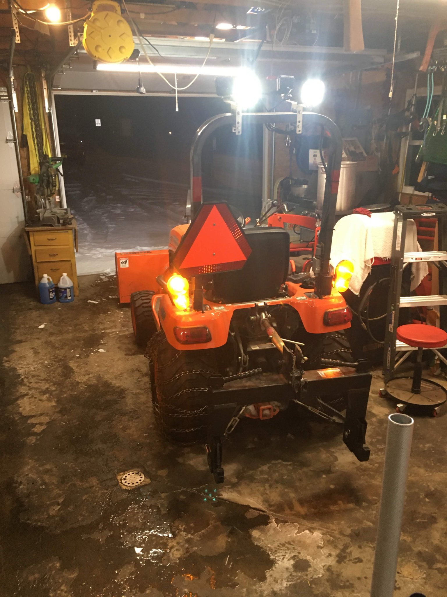

I need extra work lights for snow removal. Part is so I can see, but since I'm often in the road - - - so I can be seen by other vehicles.
Just something to consider is replacing all light bulbs with LED before attempting to convert to an alternator. A dynamo is limited in output, but they're very reliable.
Probably can switch the factory OEM tractor lights to LED, and the 4 halogens are work lights?
I started with 2 halogen work lights on my BX with an alternator (40A?). They were a huge amperage load. Could hear the engine work harder just by turning lights on. Light wasn't great either.
Went to 4 LED work lights with better lumens, and now don't notice a difference when the work lights are switched on.
Changed all the tractor headlights/taillights, etc to LED also. All were common automotive lights, just need to figure out what type. Was pretty easy to do, and inexpensive.

Toss the halogens into the recycle bin, go LED.
Never liked halogens..waay too hot,need new gloves to touch them,
Problem solved.
I've got 2, 34W LEDs up top for headlights, one's actually enough.
I put LEDs in the rear as well for turns/4 ways (LED1156 I think )
6,237
4,816
I used the color red LEDs for the red lens lights and the amber LEDs for the amber lights. They are extremely bright even in daylight on a sunny day.
