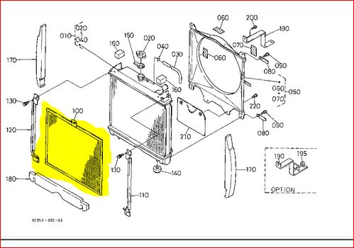

Check the radiator screen, it's the #1 reason for overheating.

Joined this board just to reply to you. I have a Kubota b2100 950 hours. I noticed that it began running a little hot. I went to the Kubota dealer. I told him I regularly sprayed the radiator with a hose. He told me when you do that the dust turns to and he mentioned concrete. He said use air. So I changed the oil. Drained the coolant. I was going to remove the radiator. Didn't touch the transmission cooler. Removed the screws front and back of the radiator. I unconnected the top hose. I could move the shroud back a little. I pushed the top hose just to seal the radiator. Don forget the CAP. I got a long air nozzle and blew from the inside toward the front esp. the center and corners. I then spayed the radiator from engine side and from the front. I then sprayed the radiator, the shroud. Replaced all the screws. Added coolant. Mowed for 3 hours. needle about 1/8" above Cold. Just like when I bought it in 2000. Hope this helps.
