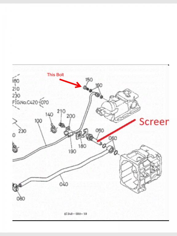

Kubota USA has an online illustrated parts manual so Kubota Canada probably does also if you can’t get to the USA site.
The picture you posted seems to be from another of your threads where someone posted it. It looks like it is from the Kubota parts illustration

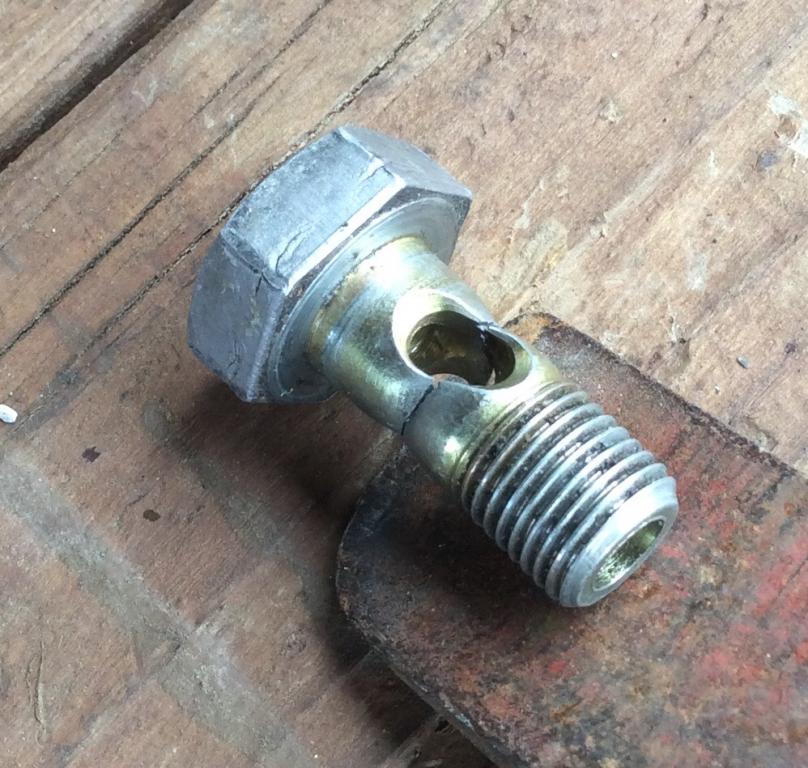

{I'm assuming here} but seeing its a Kubota, its "probably" metric..
The most popular sizes are 12x1.5 or 14x1.5mm just go to your garage, grab both those open end wrenches & see what size fits THE THREADS the closest, using the open end side of the wrench..
Then go to Home Depot/Lowes/ Local Hardware Store or now that u know the size, order online.. Good luck.
