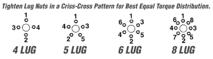

1 100 td Active member Equipment B21TLB (B21, TL421 & BT751) Toyota SDK4 T116 Bobcat Aug 29, 2015 1,776 9 38 ɹǝpunuʍop Sep 9, 2018 #2 R U talking about tightening, 6 bolt IIRC, one or 2 bolts?EDIT: Pic below Last edited: Sep 9, 2018
