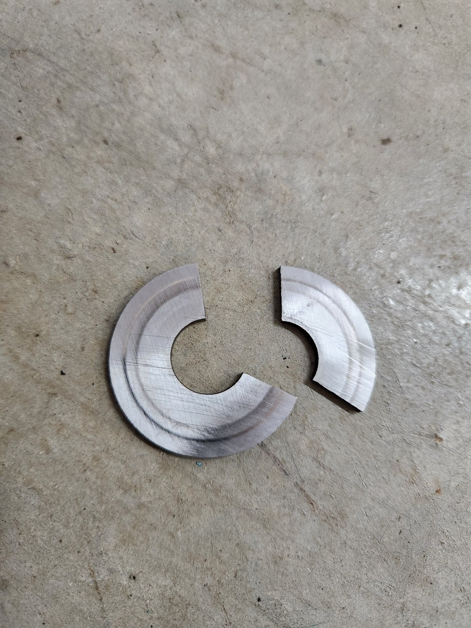

Hello,
I recent purchased a B1750hst that needs some work. The power steering is turning the wheels to the left on its own. Any ideas of where to start looking? It's very hard to pull the wheel clockwise. Any insight would be appreciated.

Your problem is in the steering box itself, sounds like it needs a rebuild.
Parts are getting hard to find for these boxes.
Do you have the WSM (aka service manual)?

Thanks for the reply. Yes it seems like there is something blocked up in the pump, or something is way out of adjustment. There are two adjustment screws on the unit. One for the pressure relief valve that is peened, and another on the opposite side. Would any of these has bearing on steering direction? It looks like Messicks has all of the seals in stock if I need to rebuild.
