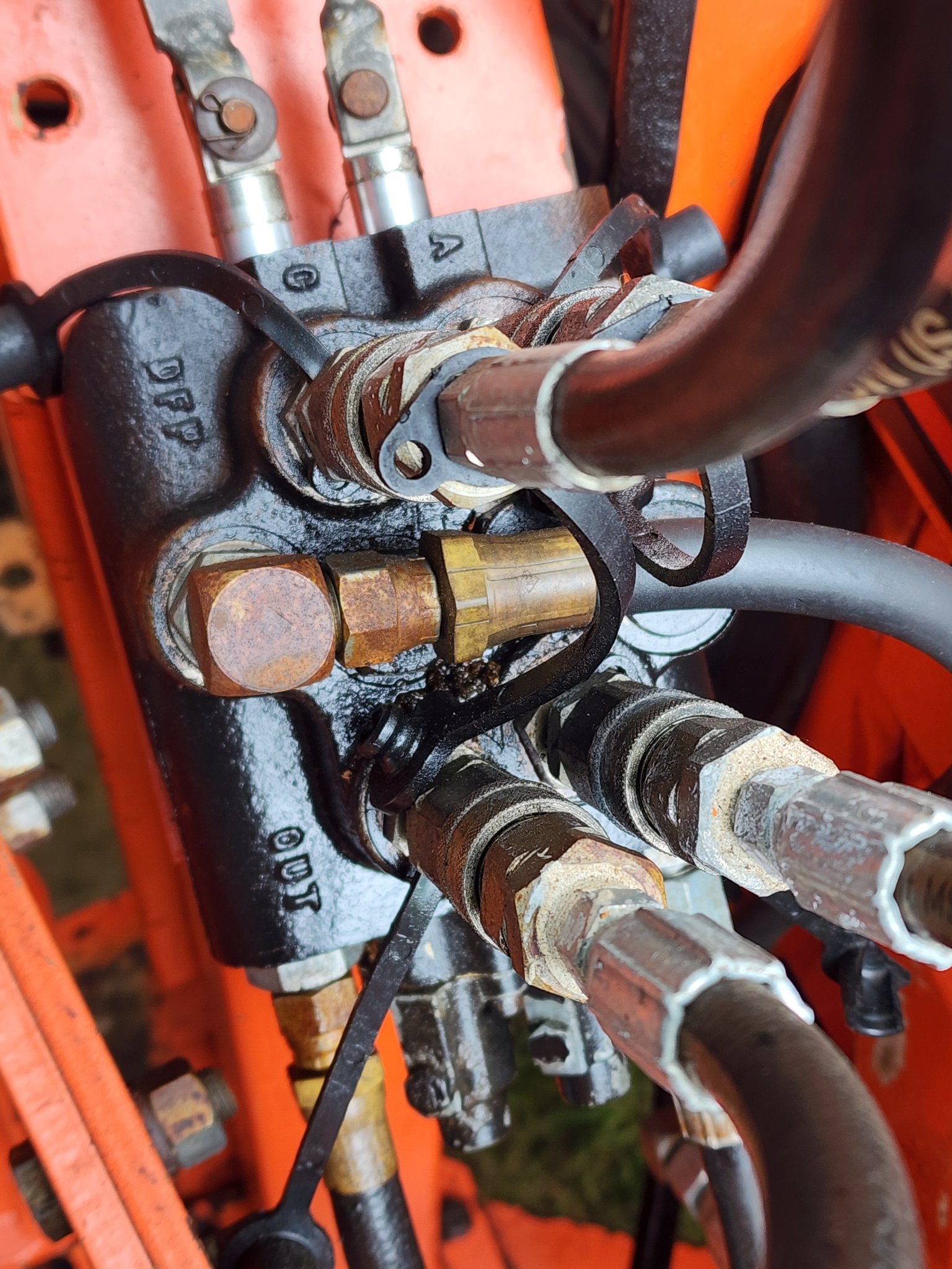

Checked pressure at block - also 1600psi.

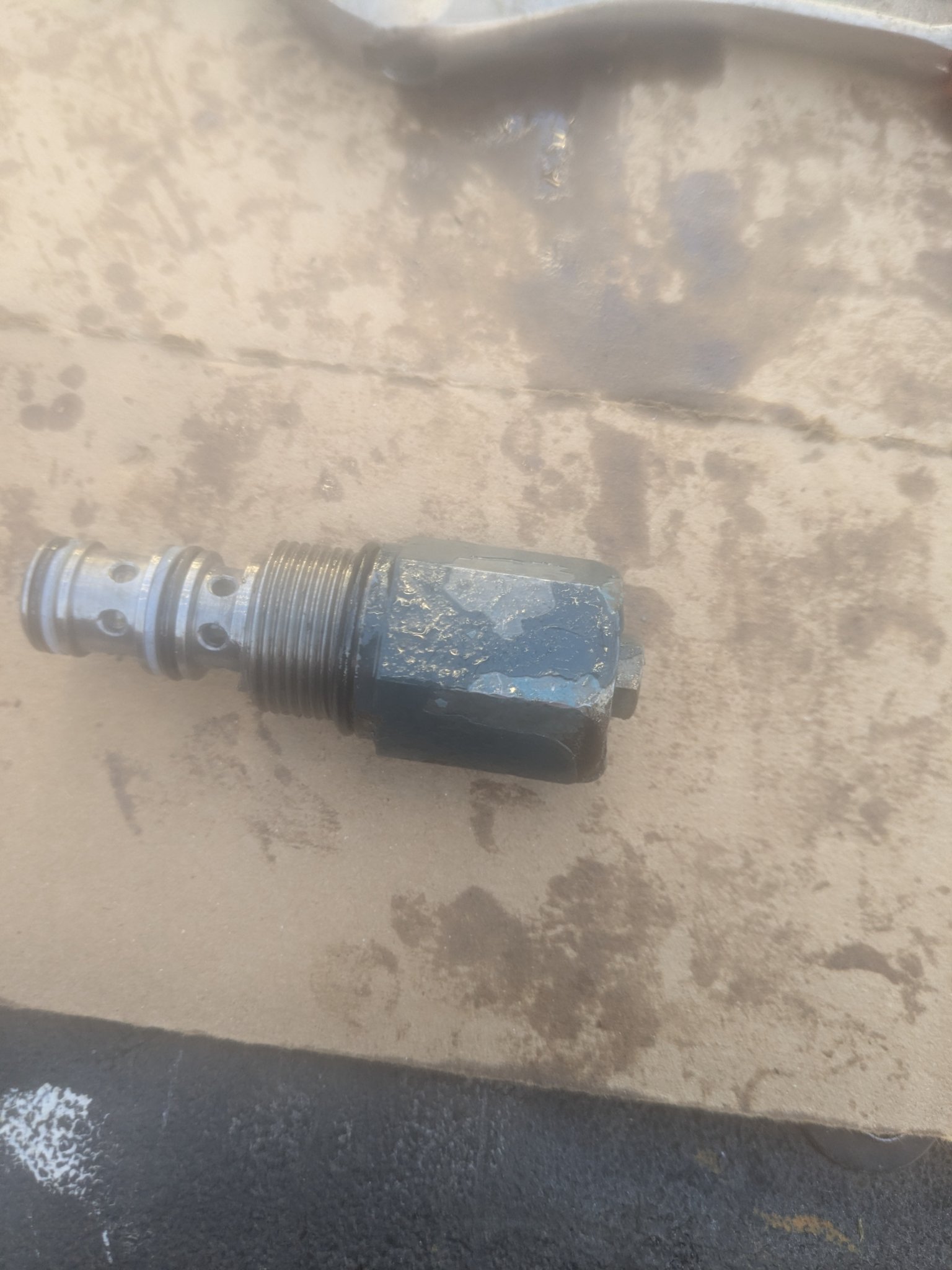

Pulled relief valve from block and would like guidance shimming/adjusting pres. relief before I attempt to do the job. (I returned the loader valve relief to original pressure until main pressure is at normal psi.

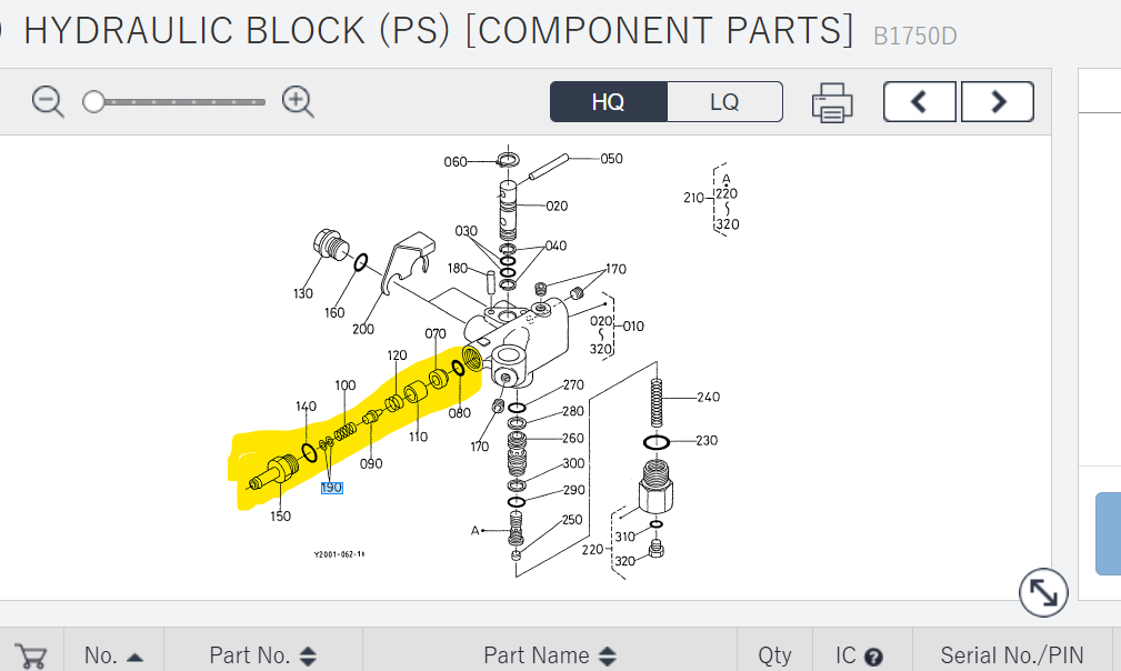

WHOA... Put that part back in, that's NOT the pressure relief valve , that is the divider / proportional valve, do not change anything with it.
The pressure relief valve is under the tank / overflow fitting (#150).
The pressure adjustment shims are #190 in the picture.

I will now bring pump pressure up at the "P" line before loader valve. I will keep it under 2000#. Then adjust at the loader control pressure relief. That's a screw adjustment or should I shim it. I have plenty of various thickness shims.
